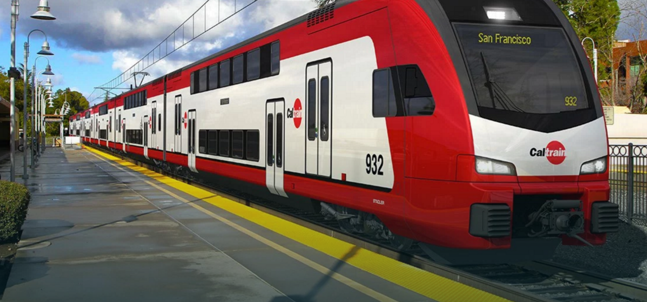

(2) Caltrain is ordering the dual-door-height version of the Stadler KISS, a heads up given by drum118 in 2016, photo credit
205865
What happens would be that GO orders a mix of the same type trainset
  • some trainsets with doors at one level (legacy only)
  • some trainsets with doors at both levels (legacy + UPX)
  • same train model, just some with optional dual-height option
- All trainsets (including for Pearson) can run on the whole current GO network
- Pearson-compatible trainsets would have the high doors & baggage racks.
- All trainsets can couple to 4/8/12 coach, with Pearson trains being 4 coach
- Fleet commonalty with low maintenance.
- More flexibility for slow-buildout to future GO level boarding options (2028 milestone kinda stuff)

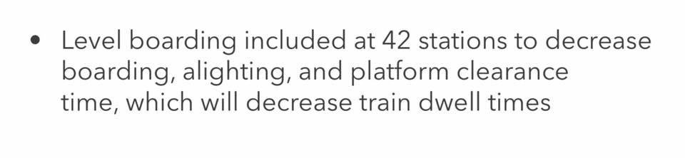

Metrolinx said they intend 42 stations to become level boarding in the December 2018 meeting, and repeatedly mentions "level boarding" as part of the GO Expansion (the thing that used to be called GO RER for 2025, now targetted for year 2028).
205871
There is -- as of yet -- no final decision on level boarding height, but this will influence the practicalities of merging UPX+RER. The two main platform height candidates are likely existing BiLevel floor height (~20 inch) and the standard 48" (existing VIA/UPX) with their attendant compatibility pros/cons.
