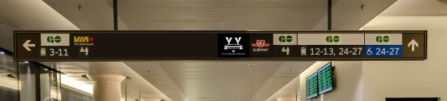

I really like the detail of the new sign brackets/mounts. The square relief around the perimeter and in the corner really plays into the architectural details of the station. For this reason I would shy away from options B, C & D as I believe they undermine this small but important design detail. While improving the wayfinding; the diagonal, the rounded, and the white border do not necessarily play into the design details of the station as a whole.
Can I suggest a mock up based on option A whereby all vertical elements "or lines" are removed except where they divide directions. Additionally if the proper logos were used to replace text this would allow uniform widths and spacings. Ie. Replace "Air Canada Center" text with logo of same dimensions as TTC logo.
Something like this perhaps?
All aesthetics aside, in terms of straight-up "wayfinding function", I think option C is the best bet but could definitely use some interface tweaking. The way Union/Metrolinx have chosen to display the platform numbers is just outright silly.
There is a lot of room for variation what constitutes a successful design. For example, there is no one correct font. I suspect that there's room for further improvement if we're not limiting ourselves to reusing existing design elements.
Having said that, I think you've absolutely nailed the core usability issues. The extraneous white lines and the inconsistent handling of the platform number segments are easily the biggest issues, and with those resolved, it's so much clearer.
I like your version, but I think you still have to write out Air Canada Centre for those game night travelers who are looking for those magic words. They won't necessarily recognize the ACC logo without it being spelled out. I've encountered many people coming through the station from the subway looking for the ACC, so making it easier to see on the signs is critical. Major destinations like the ACC, Ripley's Aquarium, SkyDome (aka Cable/Phone co. Centre), and CN Tower should have prominent wayfinding signs, and not be shoe-horned into these station navigation signs. The signs should be in clear and consistent fonts, with arrows, like the signs used on subway station walls. Those temporary signs with all the logos and odd fonts jammed into a square sign are examples of what not to do. People looking for these places aren't generally regular commuters and need easy to follow signage.
