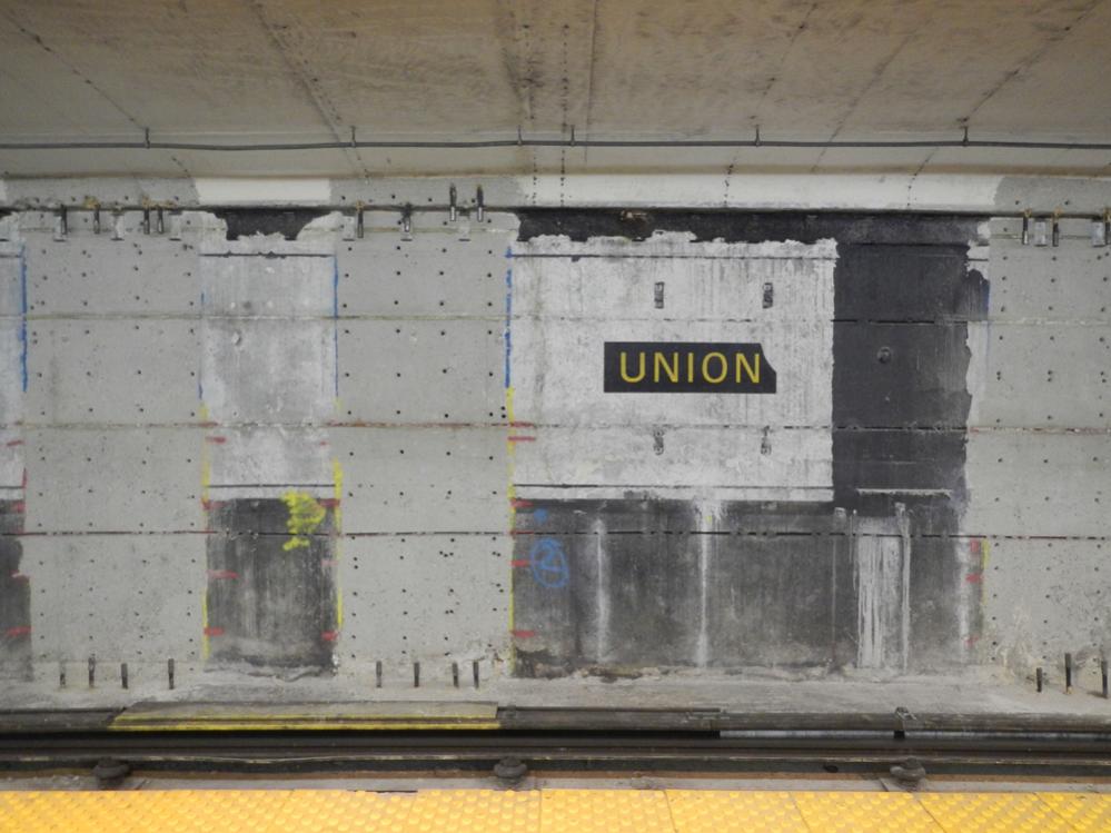

Latest progress of the north wall. Some pillars are taking shape at the west end.
I'm a bit confused by the work on the north wall since I had thought that other than esthetic improvements they wouldn't have touched that side but I guess the support for the roof wasn't enough once stairs and supports shift south on the platform.
North Wall as of last night.
No pictures unfortunately as my battery was dead, but some of the forms have been taken down and the columns are visible.
Feb 02;
The north wall is being reinforce so the box will not flip when the 2nd platform is built.
The southbound signal to the platform has been moved to the platform and crews were working on the new one at the east end yesterday.
So is the idea here, that once the new platform is completed that knock out the walls between these new columns?
What I don't understand is, why use discrete columns instead of just making the whole wall thicker? Seems like a lot of extra fuss-work. Did they need to maintain refuge spaces on the north side?
I'm a little confused about this project. When this is done will there be two north-eastbound platforms to Finch and two north-westbound platforms to Downsview (so 4 separate platforms), or is the platform just being widened.
