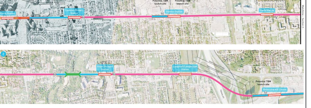

EDIT: From the report, all cut-and-cover (Fig 4-19 is a map):
• From the north end of the Richmond Hill Centre Station to the end of the
proposed tail tracks north of Richmond Hill Centre Station
• From the south end of Royal Orchard Station to 100 m south of the East Don
River; and,
• From the south end of the Cummer/Drewry Station to the existing tail tracks north
Everything in light blue is C&C:
So in one sentence you managed to be wrong on multiple levels. Impressive.

Yeah - from p.84 of the Enviromental Project Report (regarding RH terminal station)
"Positioning of the cross-over track and subway station (which require cut-and-cover construction..."
"For some portions of the subway line, excavation by a TBM is not practical or
economical. This includes:
• Stations – The large spans (station platform widths), relatively short lengths and
complicated spatial arrangements normally preclude economical tunnelling.
• Cross-overs – Similar to the three track structure, the cross-overs for Finch
Station, Steeles Station and Richmond Hill Centre Station have special structural
configurations and require the placement of special track work.
In these instances cut-and-cover is the preferred method of construction. In addition,
where the alignment can be close to the surface and access from the surface during
construction results in negligible adverse environmental effects, cut-and-cover can be
more economical than tunnelling.
River; and,

wonder if the plans have changed now that the Royal Orchard station isn't happening. I guess we will see when the detailed design resumes. They had quite a bridge planned over the river, but if they can go deep due to the lack of proximity to a station, they may switch to an entire TBM run deep underneath of it.
The 2012 Conceptual Design report doesn't include Royal Orchard station, and notes that the East Don River "bridge is required regardless of whether Royal Orchard Station is included as part of the project".
