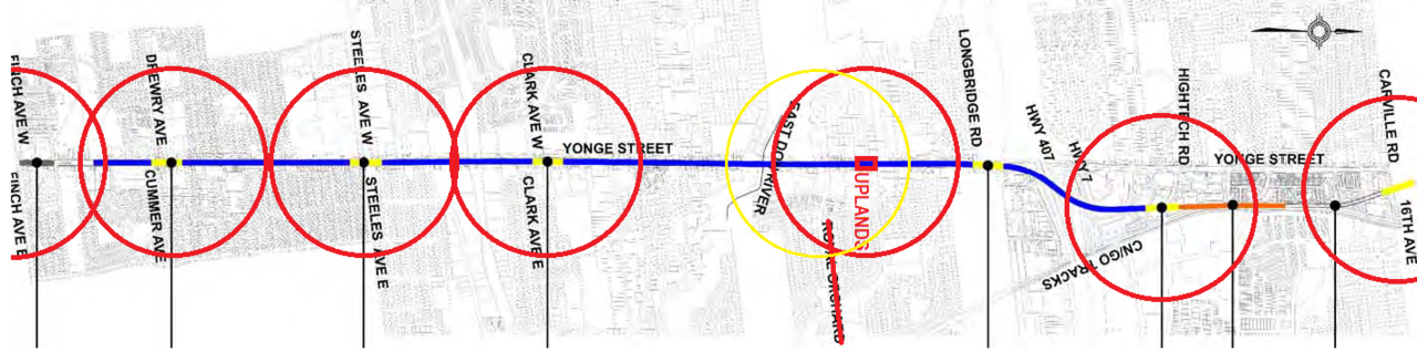

Agreed. But I think 1000m station spacing is reasonable, and even some of these deep emergency exists using TBM are quite expensive and disruptive). The straight line is 6.8km, and stations at Cummer, Steeles, Clarke, Centre, Bay Thorn (between Royal Orchard and Langstaff, which is under a hydro line), and Richmond Hill Centre. (If you really want a 407 station, build a flyover ramp for eastbound 407 to directly access Richmond Hill Station). That's 6 stations, or 1.15 km between stations.
Two afterthoughts.
1) Maybe Centre is not the best idea. Due to the Don River, it's catchment area, just like that of Royal Orchard, is half absent.

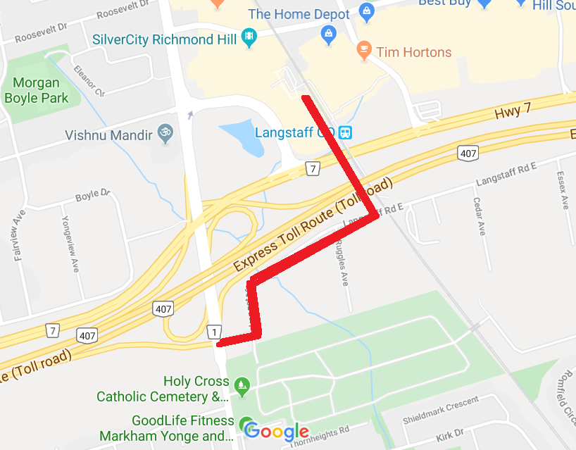

2) Connecting 407 to Richmond Hill doesn't eve require a flyover. Just build a new connector road under the end spans of the 407 and highway 7 bridges. You're saving a couple of hundred million on a station, so a couple of dozen in road improvements is still a good deal. (Do we know if the 407/Spadina station is getting good use?)
