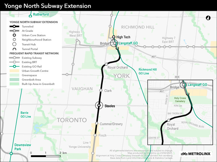

And here's the official route map which matches what was posted above...
This also answers speculation about the Langstaff station; it's now called "Bridge" (?) and appears to be directly beneath the highway, which is where the existing GO station is anyway. Obviously I'm on record as a long-time booster of this project and this requires some absorbing and I'm sure some people north of Steeles will lose their stuff.... but I kinda like it? It solves some problems and clearly works around some constraints and transit planning in these parts is always interesting.

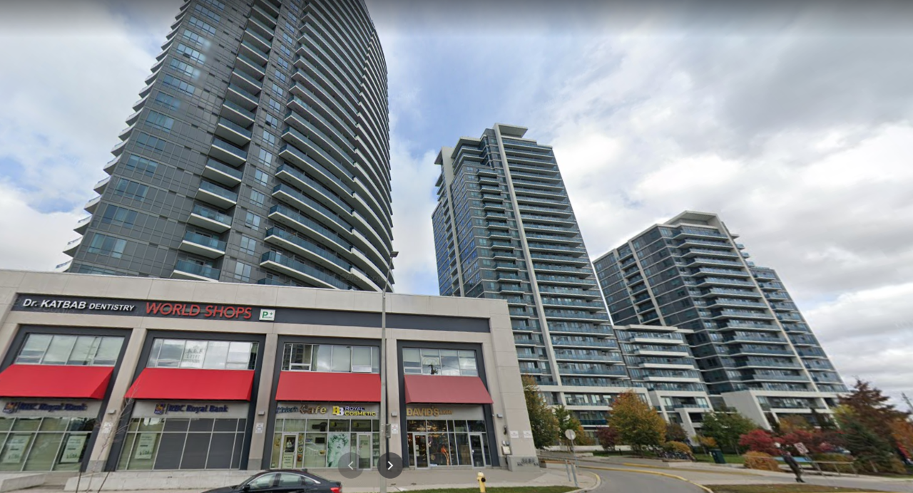

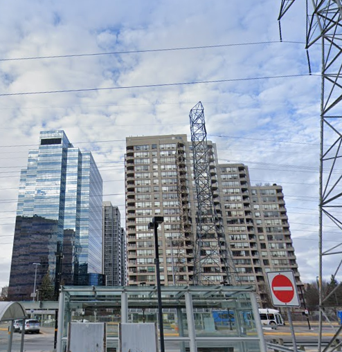

Not for most of that length.
Unless you're intending to go directly over Yonge, and even then, its problematic.
This is what its the way of an elevated alignment.

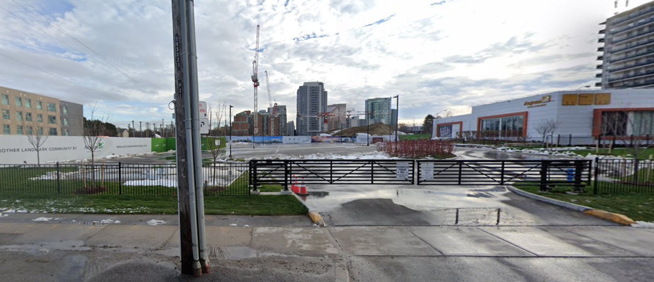

The the massive M2M development:
Then this one:
A good chunk more of the land has already been upzoned for high density with approved plans.
Putting elevated tracks over the level'ish sections of Yonge would be feasible; but room for stations would be problematic without shadowing the entire roadway. Making it unlikely to receive support.
I wonder if at least part of the reason this is so expensive is because of tunneling depth (making each station more expensive). The IBC addendum points out that they’ll be at significant depth under the subdivision to avoid noise impacts, and mentions significant depth to go under the East Don.
Also, why on earth are they planning to build a station at High Tech, 400m from the 'Bridge Station' at Langstaff GO?
