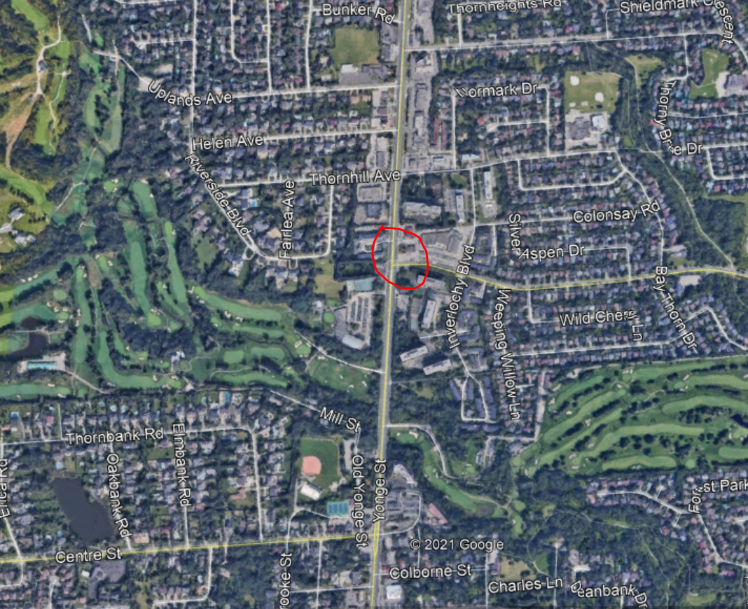

Royal Orchard has basically 1 big development site and not much other potential.
Poking around on Google Maps, I see room for 8-12 towers between plaza redevelopment and tower in the park intensification. Might not be that bad. Is it viable to go elevated north of the CN corridor? Hopefully the Feds pitch in money to build Cummer, Clark and Royal Orchard on day 1.
IMHO, no. For one thing, there's the Thornhill Heritage District and then there's the valley where the golf courses are.
There is SOME redevelopment potential around Royal Orchard but the valleylands to the south make it a bit more detached from the larger corridor than Clark and Cummer, especially on the west side of Yonge. If you look at how close the low-rise houses come to Yonge Street as you go north, as compared to further south, by Clark, you also see the challenges of going too high and deep there.
Able to post the Google Maps link for where the station would be located?
It's a shame we never bundle suburban subways with intensification. I'm sure the BCRs would improve substantially if everything within walking distance of the stations was upzoned thoughtfully.
IIRC, one or two towers were proposed for the golf course to the south west of that intersection.
Looking at the map again, it actually looks like Royal Orchard has at least as much redevelopment potential as Clark, maybe even more: 6-8 towers for Clark, 8-12 for RO.
Here's a link. It helps to see the topography if you don't know the area, as there's a big valley to the south.
