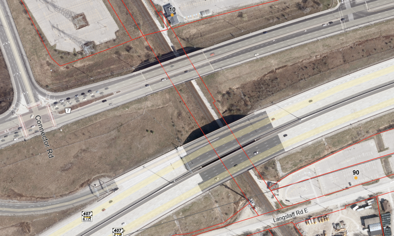

There doesn't seem to be any room for two subway tracks and a third track on the Bala sub under the 407 bridge.
The clearance underneath the 407 bridge is almost 250 feet. There is tonnes of room for a subway, and more tracks than CN would know what to do with.
Mmm, I think someone else posted this map before but CN's ROW is definitely not 250 ft.
A quick measurement shows it as less than 35m and when you keep in mind that structures - like buildings and highway abutments - have proximity requirements (usually 30m, I believe, from the tracks) I suspect that there is not room for "more tracks than CN would know what to do with."

You're right, the ROW is not 250 feet.
But the clearance from abutment to abutment of the overpasses is what is being considered here, and that distance is far greater than the ROW's width.
In fact, it looks as if the subway could be built entirely outside of CN's ROW there.

OK. But to rephrase my point /question
Doesn't any new track have to be at least 30m or something from the abutments? Doesn't that obviously reduce the potential width by a lot?

Before I answer that......think about how that would look, exactly. And then look or think about any new grade separation and consider how much - or little - space there is between the tracks and the structure.
So no, track does not need to be 30m from any structure. What needs to happen is that any structure within 30m needs to be reinforced against any potential collision by a train, and that reinforcement can take many different forms.
OK, fair. It's not my area of expertise.
I'm not sure how the new grade of the TOC development impacts this or how CN /MTO would figure out costs of reinforments. But it's not impossible, is the main answer, I guess.

That's just it, for a greenfield installation it's easy because you can build in the protections from the outset.
For something like a bridge - which is already quite solid - the mitigation measures may be as simple as building wing walls adjacent to the abutments.
I couldn't help but notice many railway bridges don't have any kind of fencing, presumably because if a train went off the track far enough to fall off the bridge, a fence wouldn't stop it.
Considering the weight and forces involved, a fence would not do anything. A wall would have to be quite robust - and thus, quite heavy - in order to do anything, and so would come with its own set of drawbacks.
That's why most protections on bridges are limited to things like guard rails and limiting the amount of special trackwork around the structures.
