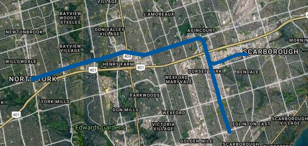

This alignment?
This alignment?
The lower leg yes ... I'd curver a lot shallower west of Agincourt ... but yes.
Hmm, the leg to STC is interesting as well, if it could be done above ground, near the current Line 3 elevated alignment. Maybe not now, but as densification continues.
Where 's this from? Every time one has a new idea, someone else has already thought of it ... :)
I took your suggestion and made it myself.
It's for all intents and purposes a variant of the Scarborough Y that pushes eastern extensions into a future phase and reorients the Kennedy leg.
Personally I tend to feel like the ideal at this point is to do roughly this, but in an even more minimalist version that uses the 404 and 401 rights of way to minimize tunneling. Given the level of political commitment and my inclination not to fight over it any more I'd be inclined to, if at all possible, cut the Kennedy branch and build the Scarborough extension, but terminate at STC with the SRT Malvern extension in it's place.
First key point. Can this Sheppard line elevation from the existing platform fast enough to cross 404 elevated and just south of Sheppard (where there are no off-ramps. That's how you can save serious $$$. Then continue along Sheppard elevated.
2nd key point. If anyone complains about elevated, the alternative is not TBM, it is a different route that doesn't even give them a station. In this case, 401 (maybe Progress).
I don't think there is enough room between Don Mills Station and 404 to get up and over the highway, even at a pretty steep grade. Would have to tunnel under the 404 or rebuild part of the line west of Don Mills.
Going over the highway is only possible if you're already nearly at grade at Don Mills, and with the existing tunnel that's just not possible. It would be much easier to surface at some point between Consumers and Warden. I don't like the idea of not having a stop at Agincourt GO either, since it would provide a much better connection between North York and Markham than the current Viva Green. I would rather have the route take the west side of Midland Avenue, where between Sheppard and Progress there is ample space between the industrial properties and the roadway for an elevated track.
Turning south later is always an option, but I'd also like to see a look taken at tunnelling under the 404 while turning south with the portal oriented north/south on the east side of the highway.
The idea is that it deals with the grade issue while still maximizing use of the highway corridor. As in it gets to an elevated guideway within the highway ROW in as short a distance as possible. The alternative would, I suppose, be a portal within the Sheppard Ave ROW and following roughly Ann O'Reilly Rd to get the 401, but the TTC seems pretty committed to not putting elevated guideway in road allowances, though I wonder if the Ontario line in Thorncliffe and Flemingdon might start to change that.
