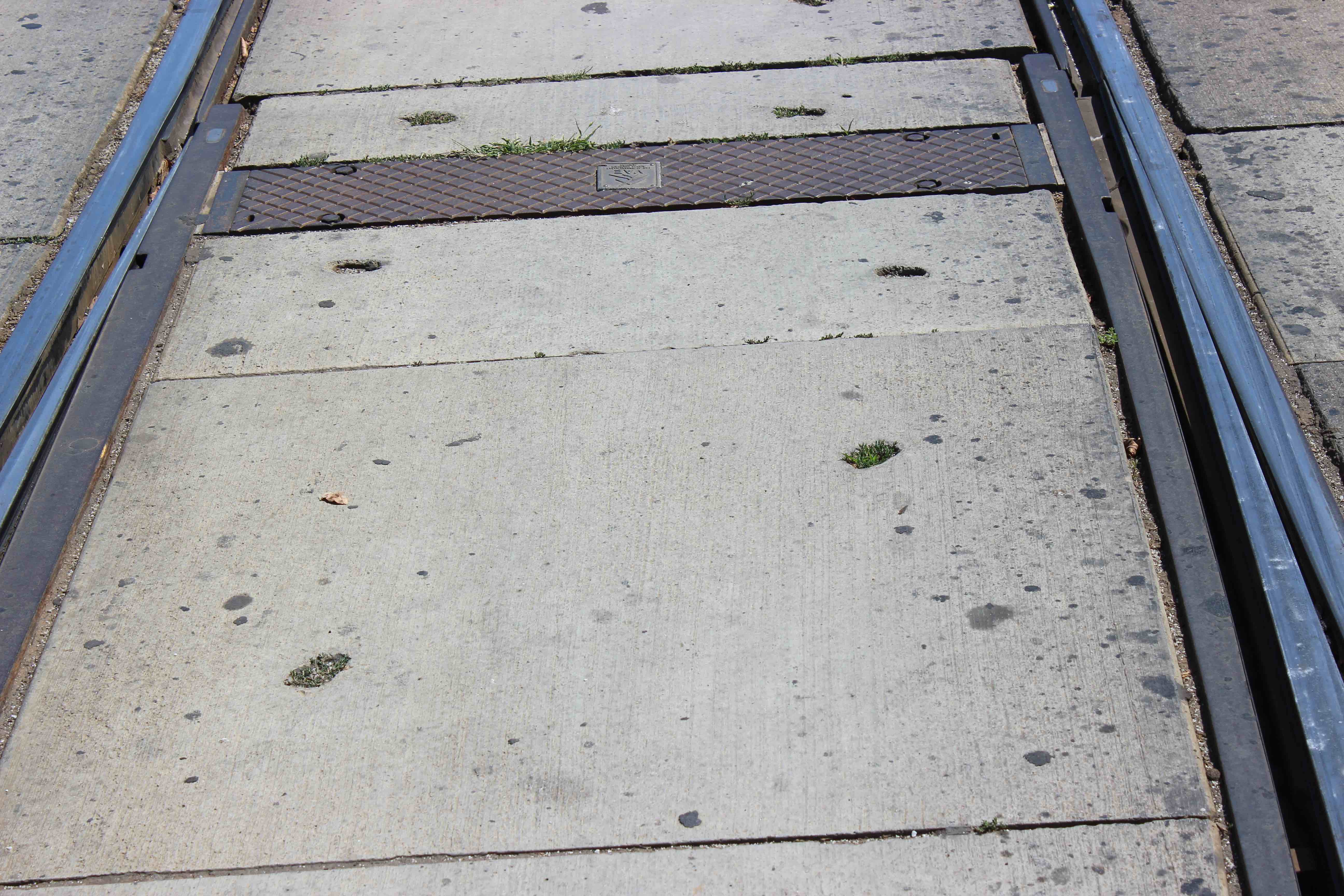

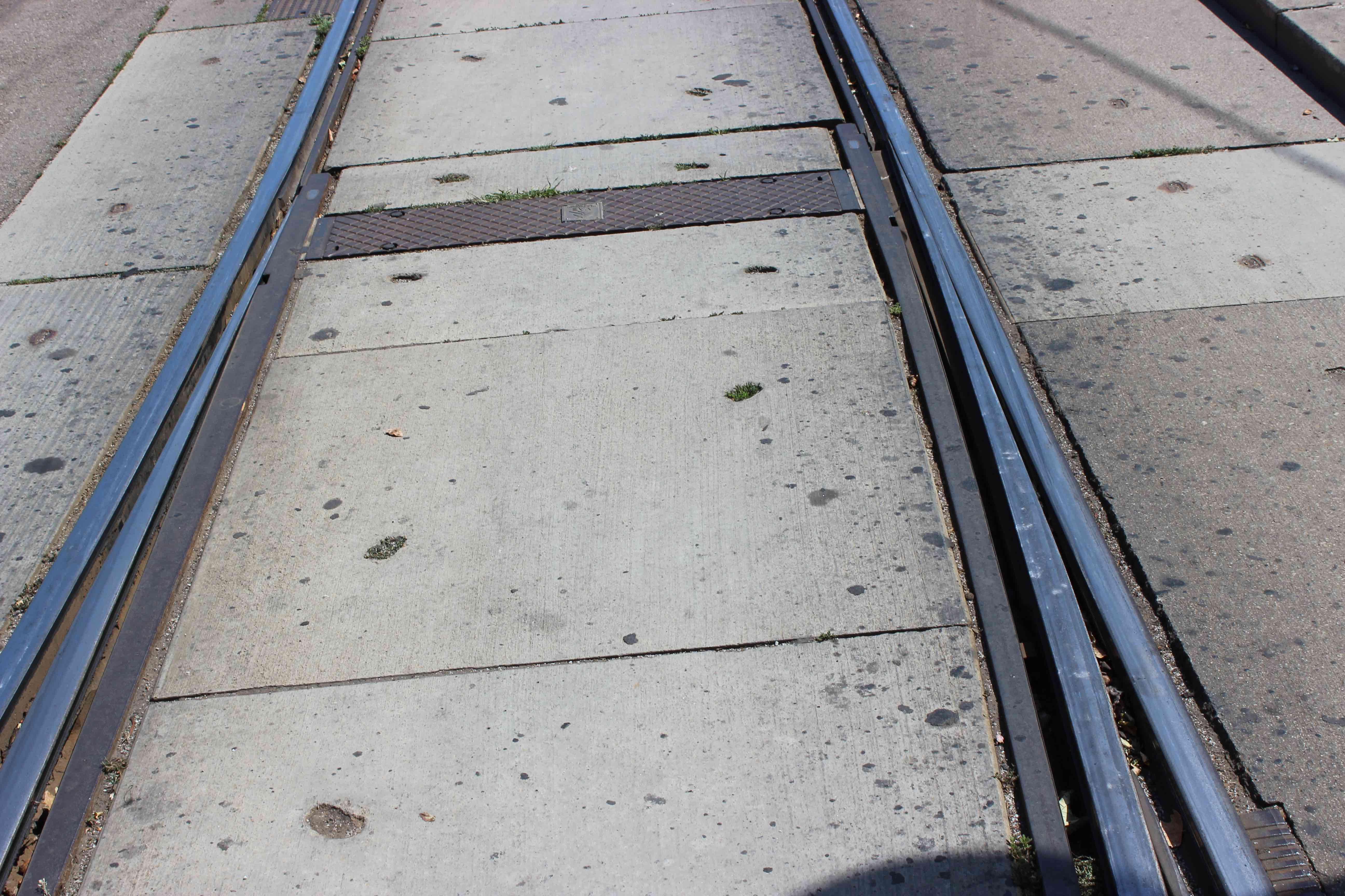

One problem that remains to be fixed is the requirement that streetcars have to stop at each and every track single-point track switch. Service can be improved if they didn't. In Europe, they use double-point switches (like we have on the subway). However, because on "cuts, cuts, cuts" on the TTC budget, there is no money available. I put the blame on the suburban Councillors who do not use public transit and see no need to improve streetcar service.
In that sense, having a network with many redundant tracks has its disadvantages. Redundant tracks unused for regular service do allow to bypass construction areas more easily, but they result in more track switches where streetcars have to stop. Perhaps the riders will be happier with faster regular service, at the cost of having to ride replacement buses during the construction periods.
Btw, I didn't see many redundant tracks on the European streetcar systems.
