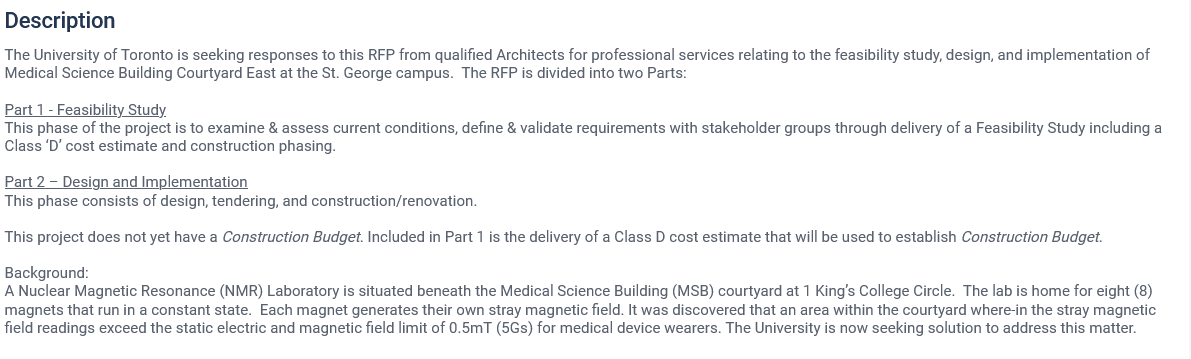

There's a new 'landscaping' project in the offing here, probably........it's not part of the new build project, nor is it part of the Landmark Landscape project....
For now, I'm going to park it here......
It's just interesting enough to merit some conversation, while not yet demanding its own thread.
@AlvinofDiaspar being very intrigued by all things science may find this more interesting than most.

Add mu metal shielding?

I think they're trying to build something that shield the public from stray magnet fields created by this device, so folks who have pacemakers and such doesn't go all wonky on them...as that could lead to unintended medical complications and lawsuits that will likely follow. Or less scientifically, U of T are building a shield around their backsides here. >.<

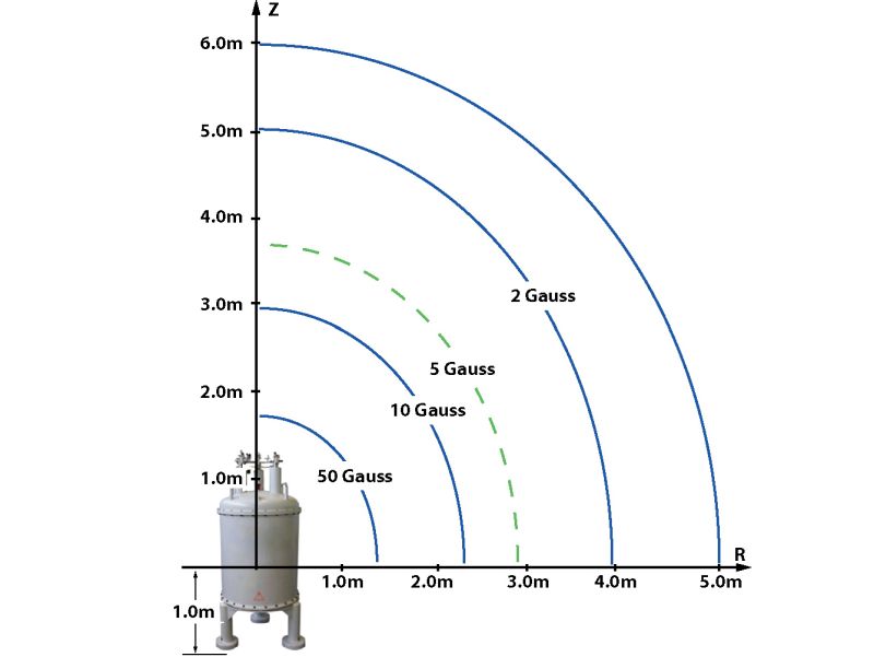

I work with MRI scanners, and some NMR scanners. There is almost always a taped outline for the residual magnetic field of 5 Gauss (0.005 Tesla) around the scanner. Electronic devices generally operate no problem outside the 5 Gauss line, which is why we have it outlined. However since NMR spectrometers are vertical, this 5 Gauss line can go many meters above the scanner (hence into this discussion of needing additional shielding for the quad walkway). Take a look at this example on how the residual field varies as a function of height for a vertical bore NMR, as well the second picture shows a red tape outline for the 5 Gauss line on the floor.
I have a feeling they upgraded a previous NMR scanner to a higher magnetic field strength (which would result in a larger residual field, peering into the quad walkway).

A very belated thank you for explaining all this. /bows
