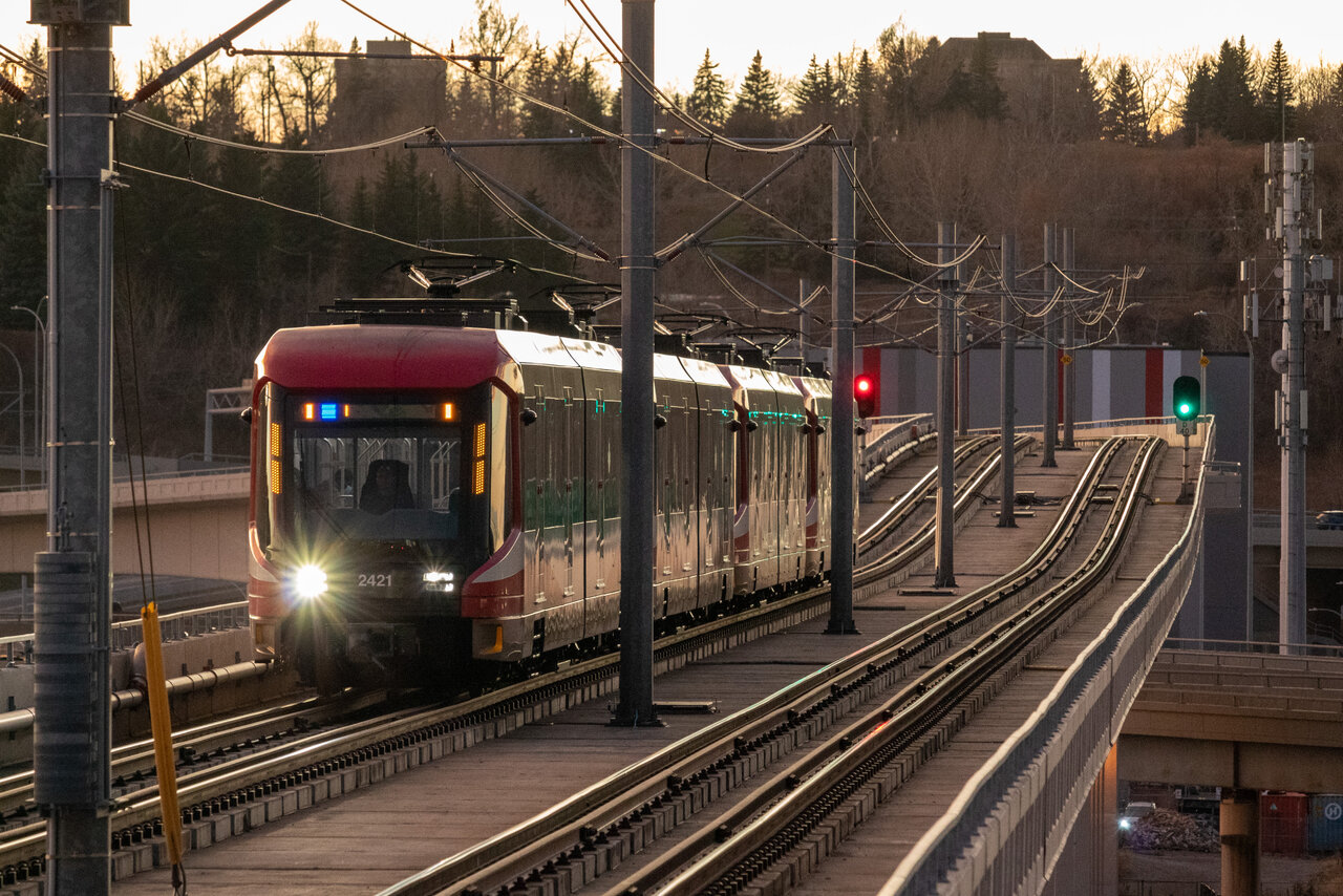

The viaduct is so wide, I measured about 12.5 to 13m on Google Maps. How can something be so overengineered and underengineered at the same time? The side barriers are so high.
The existing Dudley B Menzies Bridge and Calgary's elevated section have 11m wide viaducts. Vancouver's Skytrain is 8m wide with the double tracks for Expo/Millennium Lines, 9m wide double tracks for the Canada Line which has 3m wide trains, but they don't have catenary supports and the required clearances to deal with. Triple track sections on Expo/Millennium Line are 12m wide.
They're 1.5 to 2m too wide. For no reason.
The cynic in me believes that there will be trespassing on the tracks and bridges, and the extra width allows for better safety.
i would also wonder if the extra width is to allow for the evacuation of a stranded train in less time that could be managed on a narrower track, something which is a bigger issue in our climate than it is in the lower mainland.
Maybe, but Calgary is already 3m of room between the two tracks vs 3.5 on VL. A much chunkier guideway just for .5m extra?
