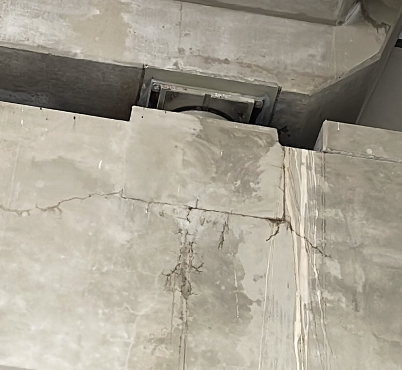

i have a hard time believing the cracks that show in rod muldaner's twitter photo are “...two small non-structural surface cracks at the corners of a construction joint between two concrete pours..." per transed's statement:
the vertical cracking and spalling and exposing of rebar down the centre of the pier where the load is greatest doesn't look like non-structural expansion cracks at a re-entrant corner to me. but what do i know, i'm just a dumb developer. :(
It's interesting in the article Transed says they have to wait for warmer weather to epoxy the cracks - it's warmer weather going to bring melting snow, which leads to water ingress into said cracks, and then a bunch of freeze thaw cycles. Isn't that just going to lead to more cracking and spalling?

They just put more scaffolding and tarps up in the last week around the two piers between Argyll and Coronet roads so why not just address this issue near the station too? Makes no sense, but I've stopped trying to apply logic to how Transed operates.
Though I’m not there to assess the integrity of the beam myself, I am forced to agree with you. That looks like two shear cracks moving diagonally away from the load and a flex crack right at the midpoint - which is precisely where one would expect those things to be if a structure’s strength to handle it’s load was in question.
