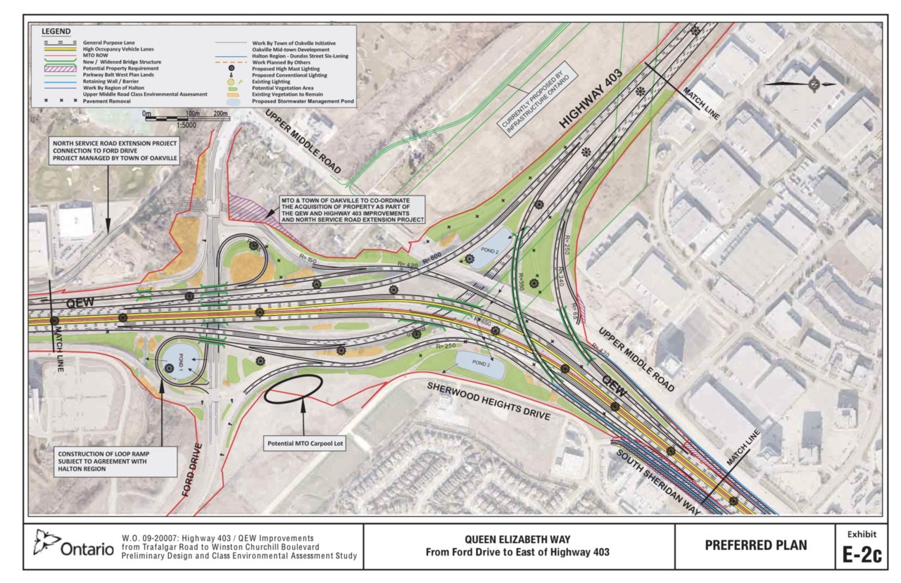

Well I’m going to bump this thread after over a decade, because work on a full interchange between the 403 and QEW a has begun, and has been underway for at least a year. Here is what the layout will resemble, from a 2013 report. Link here. I’ll take pictures and post them in this thread when I’m back in Oakville.
Construction hasn't begun, they are just doing some bridge rehabilitation and replacement.
This work is designed to accommodate the full ramp system eventually, but the ramps themselves aren't getting built.

Existing (or a few years ago), there were 4 bridges at Ford. Starting North to South (it's actually almost west to east, since QEW is almost a N-S hwy in this location), they carried;
  1. 403 SB ramp to QEW WB
  2. QEW WB
  3. QEW EB
  4. QEW EB ramp to 403 NB
Now, a new 5th bridge was added. Currently, they are carrying
  1. (new bridge) 403 SB ramp to QEW WB
  2. QEW WB
  3. Nothing, under construction
  4. (Recently replaced) QEW EB
  5. QEW EB ramp to 403 NB
traffic from #2 will be switched to #3 to allow for rehab of #2. #5 traffic will be moved to bridge #6 while it is rehabbed.
Ultimately, they will carry
  1. (new bridge) 403 WB mini-Collector lanes (from Winston Churchill on-ramp and to Ford on/off-ramp) ramp.
  2. (rehabbed bridge) 403 SB ramp to QEW WB
  3. (new bridge) QEW WB
  4. (new bridge) QEW EB
  5. (rehabbed bridge) QEW EB ramp to 403 NB
  6. (new bridge) Ford SB to 403 NB and QEW EB.
At QEW/403, the two bridges will be replaced by 2 much wider ones (to accommodate additional QEW lanes, and accommodate the staging, traffic juggling, during construction), with also a bit bigger span (to carry an extra lane underneath)
