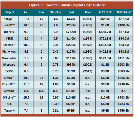

This has been asked a couple of times at consultations I've attended. The answers are generic: it's to avoid community impacts and disruption to traffic lanes was the answer given at the EWCE one, for example.
I think there are some clear advantages to cut and cover that deserve more than a boilerplate "it's disruptive" response. After all, it's not as though using traditional TBM construction on Eglinton hasn't been disruptive. The cost savings of C&C are well-established:
  • During construction of the Canada Line, according to court documents SNC-Lavalin was able to save $400 million out of a $2.1 billion project cost (?!) and get back on schedule by C&C'ing a third of Cambie
  • The European Commission estimates that C&C is "three times cheaper" (1/3rd the cost) than boring
  • Another case study found a 60% reduction in costs using C&C
We are in an era where subway construction costs are spiraling out of control so badly that we may never construct another subway line after this.
This construction method isn't appropriate for everywhere: narrow streets lined with tall buildings on shifting foundations, for instance, would not do well with this method (although Milan was able to find ways around that.) And if you are going under other subway lines, very deep into bedrock, boring is the only answer. But this section of Yonge is very wide, with generous setbacks, and we are not going under any other subway line. it is very unlikely that there is a geological reason precluding C&C. In fact, C&C is how Line 1 was extended to its current terminus (for < $100 million/km in 2019 dollars.)
The difference is that unlike other methods of value engineering, C&C improves the final product. Station access times are shorter, there is better connectivity to surface routes. Maintenance and ventilation is a lot easier. All because you are building a 2 story underground building instead of a 7 story underground building.

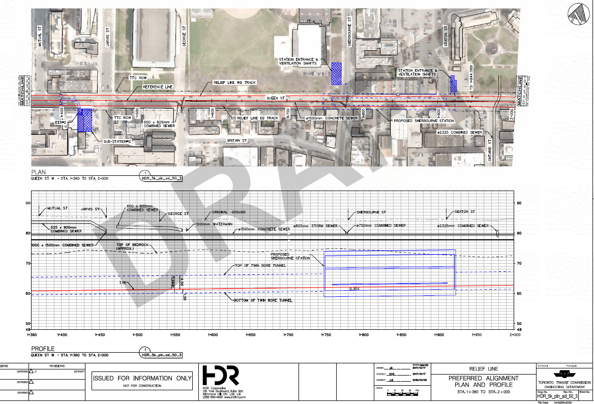

Still don't understand why ppl aren't talking about how they're going to extreme depths to tunnel under the Don. RL, where there's pretty well zero space to build a bridge, posters out of the wood work decrying how it's stupid to tunnel. And Metrolinx doing the rounds in the media saying it's stupid to tunnel under the Don. But out in the outer suburbs where there's ample space surrounded by low density? Where are those posters, where's Metrolinx saying we shouldn't tunnel? Doesn't add up.
If they use the tunnel boring machine (TBM) deep between stations, but raise it closer to the surface near the stations (and making sure the stations are off to the side), they can be less of a problem. Raising the stations closer to the surface would reduce the cost to dig down for the station box, and will let gravity help to slow the trains entering the stations and accelerate leaving the stations.
An example of such could be the Moss Park Station on the "Ontario" Line. From link.
I don't think you can really get shallow stations once you've decided to go with a TBM. That section of the Ontario line is going diagonally under foundations and utilities (including a storm sewer), so there is limited opportunity for it to rise up.
For geotechnical reasons I believe you also need to stay in the bedrock.
Here is the Relief Line Moss Park station drawing: it shows the floor of the station ~25 meters below ground.
Raising the elevation of the tracks at the stations to let gravity do work is smart, I've heard the Montreal Metro does that. But it's not going to make a significant impact on the depth of the stations.
