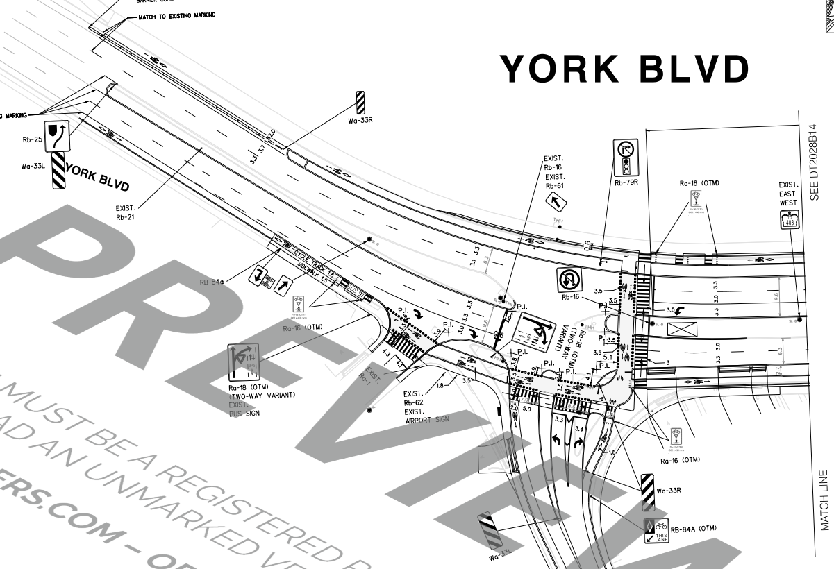

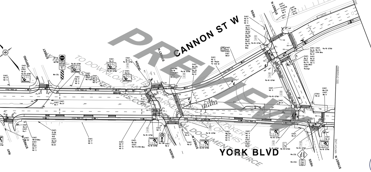

Not sure if a final design was posted, I'd imagine the design is in the tender documents - Unfortunately you can't access them without paying to register. https://hamilton.bidsandtenders.ca/Module/Tenders/en
You can make a free tender account and still access the documents.
Some key shots:
Involves resurfacing York from Dundurn to Caroline and Cannon from York to James. A small part of Dundurn will also be resurfaced from Jones to York. Curb-level cycle tracks are included, as well as barriers on the existing bike lanes between the RBG and York St-403 ramps further west.
Lane widths on York are being dropped to 3+3.3m, the left turn lane to Dundurn is being extended (yay!), the slip ramps at Dundurn are gone, the Hess-York intersection is cleaned up, a bunch of left turn spots along York are gone, a whole whack of new tree plantings are included, and Hess St will also be converted to two-way between York and Barton (though not resurfaced).

Wow. Thanks for this. Huge changes...will be a welcome update to a key entrance into the City.
Indeed. Going to make the York St entrance to the city great. York St is going to become much more important in accessing the downtown (and likely far more congested) once the LRT and Main St conversion get underway, so it's good to see this happening now to clean it up.
there are a bunch of other major resurfacing projects in the city as well this year (Wilson St resurfacing / 2-way conversion, Upper Wentworth next to Limeridge, Sherman Ave).

I downloaded it by making a free account. Appreciate the link and advice!
I like a lot of the changes. This is going to be a super fancy street. A few things I'm not a fan of. Lack of westbound cycling connection from York/Bay. Lack of PXO addition (that I can understand) at Park St. This area just requires people to run across 3 lanes of traffic. Lack of fixing the shit show Bay/Cannon intersection for cyclists (though the addition of a concrete barrier is great on the northeast corner).
Just reading through this a bit more - the scheduled completion date for all works is November 30, 2024. It will be an action-packed summer seeing as the bid closes in early May and the City likely requires a few weeks to review and select a contractor.
Pretty quick turnaround for some major changes. I suspect it will go late, just a guess.
