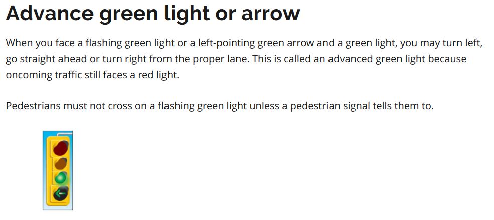

It would be colossally negligent to display a green arrow that conflicts with an active crosswalk. Doing so tells pedestrians that they have the right of way, while also telling the conflicting drivers that they have the right of way. That is a recipe for a collision and in this situation, the pedstrian will always be the one who gets injured or killed.
If you want an arrow and a walk light on at the same time, it needs to be a flashing yellow arrow, not a green arrow. That would indicate "proceed with caution" and the ordinary rules of an (unsignalized) intersection would implicitly apply, meaning that turning drivers need to yield to pedestrians.
The HTA does not explicitly assign right of way at traffic signals, it merely defines the directions they can proceed. The assumption is that traffic engineers have designed the signal phasing such that people can proceed safely according to their driver's training. Not everything that you are tested on in the G1 test is a law. Engineers also need to take into account that people do not drive based on the technical wording of the HTA, they drive based on their previous experience with roads in Ontario:
Specifically, drivers are explicitly instructed that a green arrow tells them that conflicting traffic will face a red light. The HTA can't tell people to turn blindly because even with the right-of-way a driver entering the intersection must yield to traffic already legally in the intersection (e.g. an elderly pedestrian who is still crossing from the previous pedestrian phase).
https://www.ontario.ca/document/official-mto-drivers-handbook/traffic-lights
Installing a green arrow that conflicts with an active crosswalk would be grosslly negligent and there's no point even discussing it because no engineer in Ontario would ever sign off on such a dangerous combination of indications.

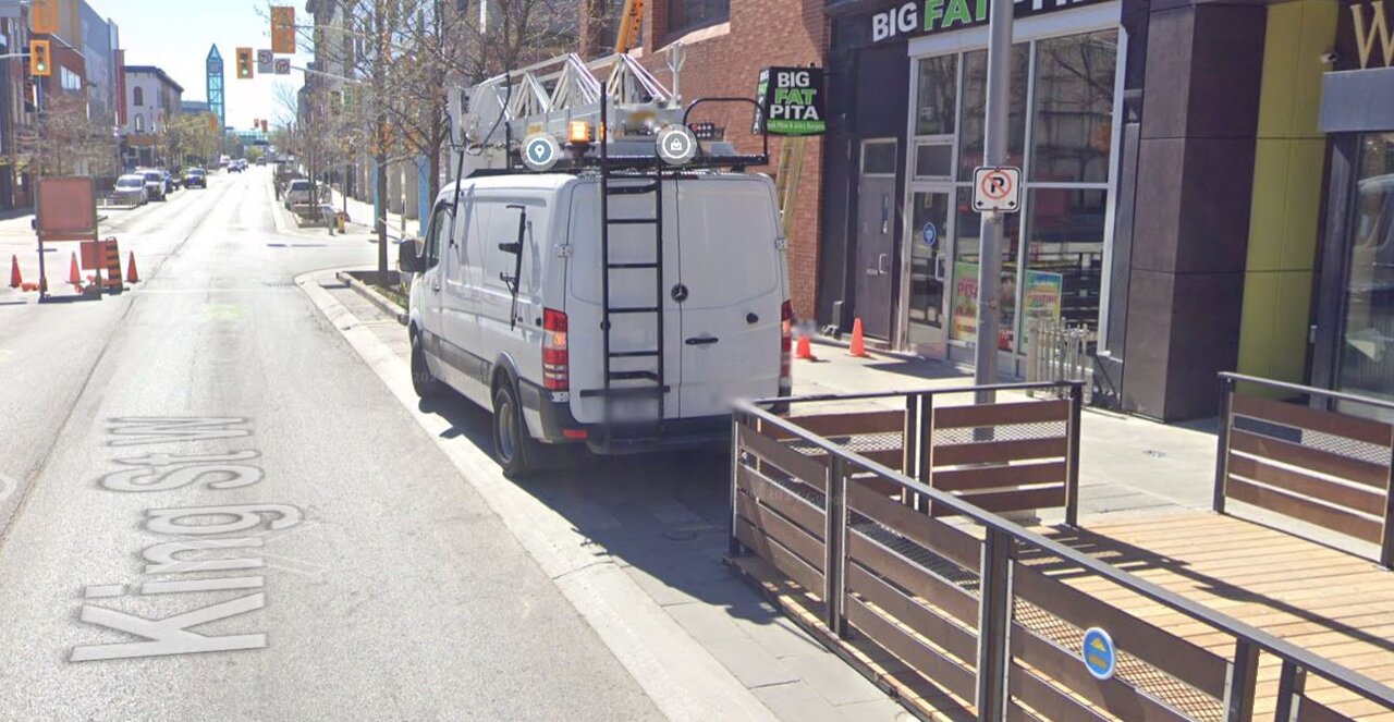

Because the current configuration is a temporary installation. The curb lane is just over 3 metres wide, so if you put in a 1.5m bike lane there's only 1.5 m left over for patios, loading zones or whatever else the city wanted to put in that space, and it's too narrow for any of those things.
When the street gets reconstructed, it would become possible to shift the curb line such that the sidewalk is consistently widened by 1.5m (which is actually useful) and some areas have a mountable curb such that trucks can load on the side of the road in a designated loading bay that acts as a sidewalk extension when not in use. That would leave space for a bike lane.

I haven't seen a diagram to illustrate this, so it's possible I may be talking out of my ass - but wouldn't this force delivery trucks to park in the streetcar tracks, seeing as the patios that do exist currently are absolutely not small?
I think I heard your ass......There would, obviously, be loading zones. :->
  • Like
Reactions: T3G
You aren't forced to leave your vehicle in a live traffic lane. You have to park further, load up a dolly and walk.
