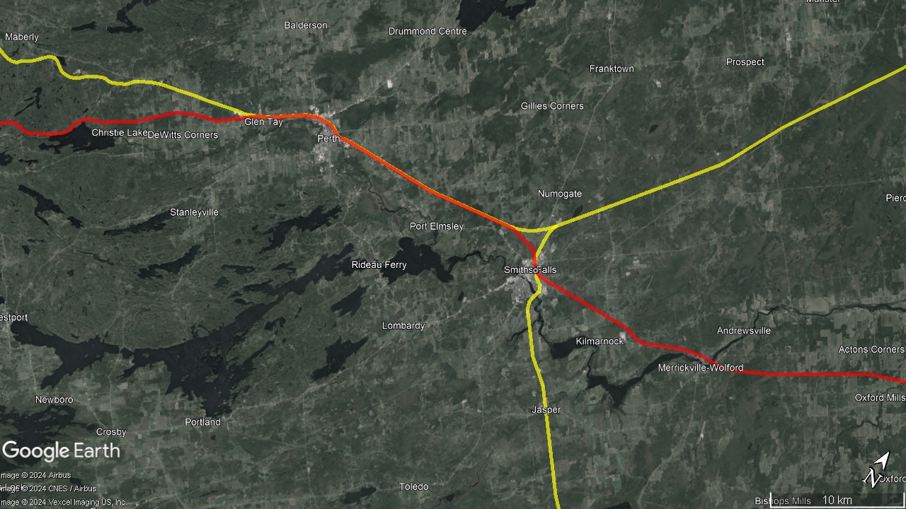

@reaperexpress that’s an interesting map of the HF/SR alignment. Is there a project document somewhere which explains the choice, such as the deviation north at Glen Tay?
The HFR proposal has the Via mainline remaining north of the CPKC line at all times, avoiding the need to have any grade separation at all. As long as the HFR option remains on the table, a flyover wouldn't be an attractive solution since it could become superfluous in the future.
Except, there will still be Kingston-Ottawa trains travelling the existing route, though less frequently, after HFR, and there is a strong possibility of Toronto-Montreal trains traversing the yard on the CP route. So there could be more trains causing a conflict rather than fewer, and this would render any sort of bypass even more complicated.

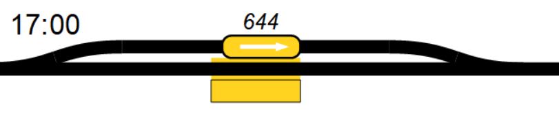

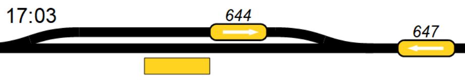

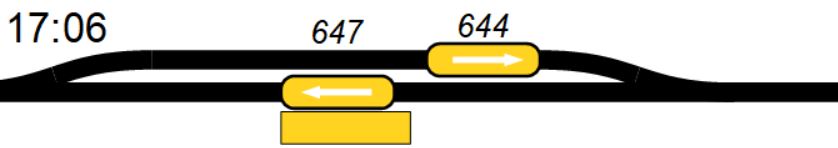

Yes, Fallowfield has two tracks and two "platforms". But due to the rules only one train can service the station at a time. If trains are to meet there, then one needs to be held out of the station while the other makes its stop.

Yes I'm well aware of how Fallowfield operates, in fact I made these diagrams illustrating the operation for an earlier discussion on UT.

I didn't think it was necessary to go into every possible detail when simply discussing the places where trains are constrained to a single track.
