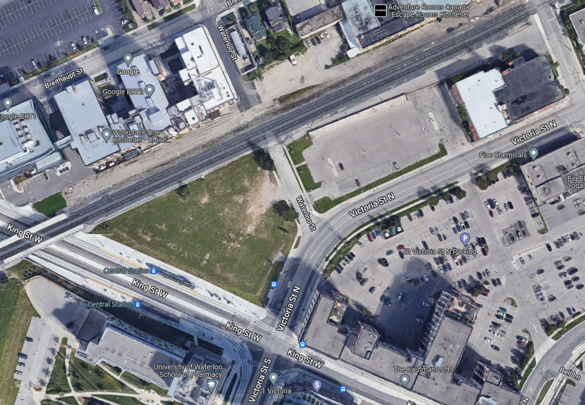

Metrolinx has said that signal sighting will be a concern if they use the entire length of the platform over King Street. The west end of the train will be close enough that reading the signals at Kitchener West will be difficult. This is also why they will be closing the level crossing at Duke.
Can the signals be moved further west?
No. There's a spur immediately west of the overpass.
Does the signal have to be before the switch? And the one for the north track can still be moved, no? It seems a bit silly to block off a road and move the platforms further away from the LRT transfer because of a signal.
In this case, yes, the signal needs to be before the switch - it guards it.
There might be the opportunity to move the switch to the Huron Park Spur a little further west if the lands there are owned by CN or GO, and thus are able to be used for a track realignment there. But even then, the most that they would gain is only about 50 feet or so - really not worth the hassle and cost.
This doesn't make sense to me - the signal gantry west of King Street is about 20m past the west edge of the bridge structure over King Street, but there are a number of stations along the Kitchener Line alone where the signal gantry is closer or similarly spaced, including west of Malton, east of Etobicoke North, and north of Bloor.
Those signals are not interlocking signals, and so are allowed to be passed even if the signal is showing red (CROR rule 436 or 437). The one at Kitchener is an interlocking, and thus can only be passed when red under very specific circumstances.
There's also the fact that just because it's done elsewhere doesn't make it ideal. There have been instances where crews accidentally ran through red signals at other platforms (Scarborough immediately comes to mind) just by releasing the brake.

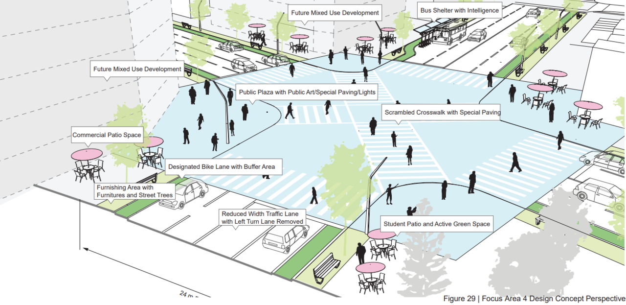

They are coming within the decade (phased), approved last year was the University Avenue Gateway Strategy which covers beyond just the universities. Details and concepts can be found here.
No concrete plans, but there seems to be a large focus on public realm activation, which is a spot that I also felt needed a lot of enhancement being this once suburban stroad is now a student downtown lined with many businesses and apartments.
King/University Currently:
Concept from the Strategy document:
This is the kind of well-intentioned but poorly implemented redesign which is sadly common in Ontario. I suspect that this type of half-thinking is also why Toronto's vision zero safety program has not improved safety at all.
- Eliminating left turn lanes also eliminates the possibility of fully-protected turning signal phases. I did a review of collisions at this intersection a few years ago, and the majority involved left-turning vehicles - including one where two cars crashed in the intersection and flew onto the sidewalk injuring three pedestrians. Usually the situation was a car waiting to turn left misjudging whether or not the oncoming car was going to stop at a yellow. This situation is completely eliminated with fully-protected signal phases since nobody is looking for a gap to turn left during the straight-through yellow.
- A scramble crossing at this intersection would require an insanely long flashing don't walk, and as a result the signal cycle length would also be insanely long. This would massively increase delay for all road users, including pedestrians. The safety benefits of scramble crossings depend on the assumption that pedestrians don't walk during the normal green for car traffic, but that is not realistic. If you're willing to sacrifice massive amounts of motor vehicle capacity (which an enormous scramble crossing would do), then you'd be better off requisitioning one of the lanes as a right-turn lane to provide fully-protected right-turn phases simultaneous with the left-turn phases mentioned above, and having pedestrians cross simultaneously with traffic going straight.
- There is absolutely no measure to manage the conflict between right-turning cars and cyclists. Again, if there were a right-turn lane, there could be fully-protected right-turn signal phases which temporally separate turning cars from cyclists going straight.
The sidewalks in the area are already quite wide. I'd be much more interested in seeing the space used to maintain and/or introduce dedicated turning lanes and dedicated turning phases, so pedestrians and cyclists can consistently traverse the intersection without getting run over. The issue here is likely that the design was made by urban designers with no understanding of traffic operations and only the vaguest concepts of ideas which are trendy "safety" improvements.
