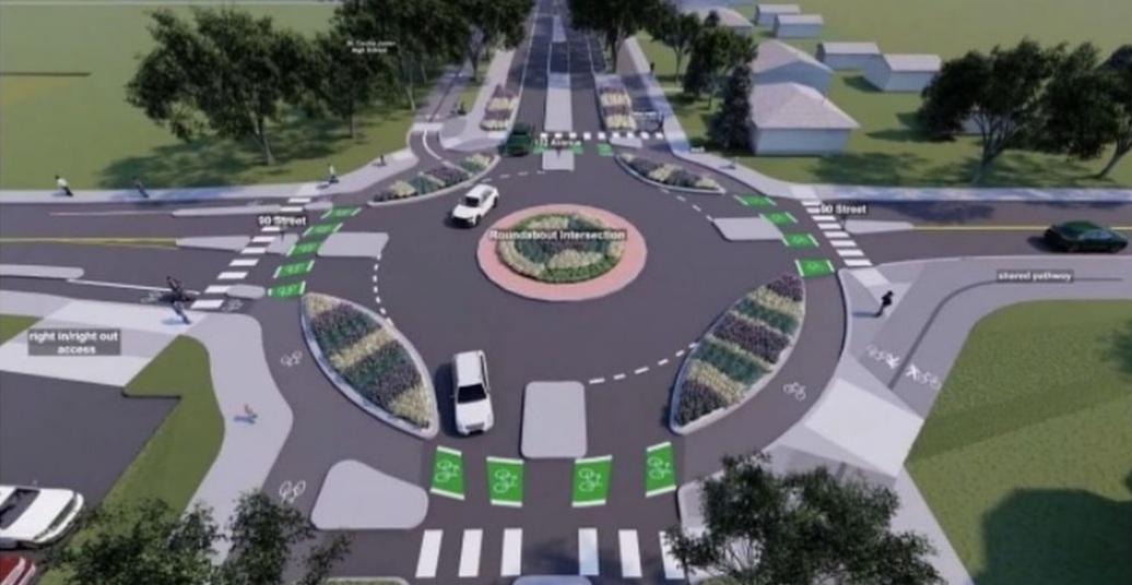

I ride past many of these in Crestwood and Parkview. And the rendering shows some color cause renderings love to give extra shine. I'm sure they'll find a sustainable solution thats not flowers getting planted every spring.
If there is anything that could do with a little value engineering, this would be it. How much will it cost to plant those gardens every year, are volunteers going to do that? The garden in the middle should just be grass with a tree in the middle. I hope the foot and bike traffic is busy enough to account for 40% of the total paved surface area dedicated towards them (the Netherlands have over 10x the traffic). What will the maintenance budget for the roundabout be like 10 years from now? This is being proposed for a location that isn't even prominent within the city.

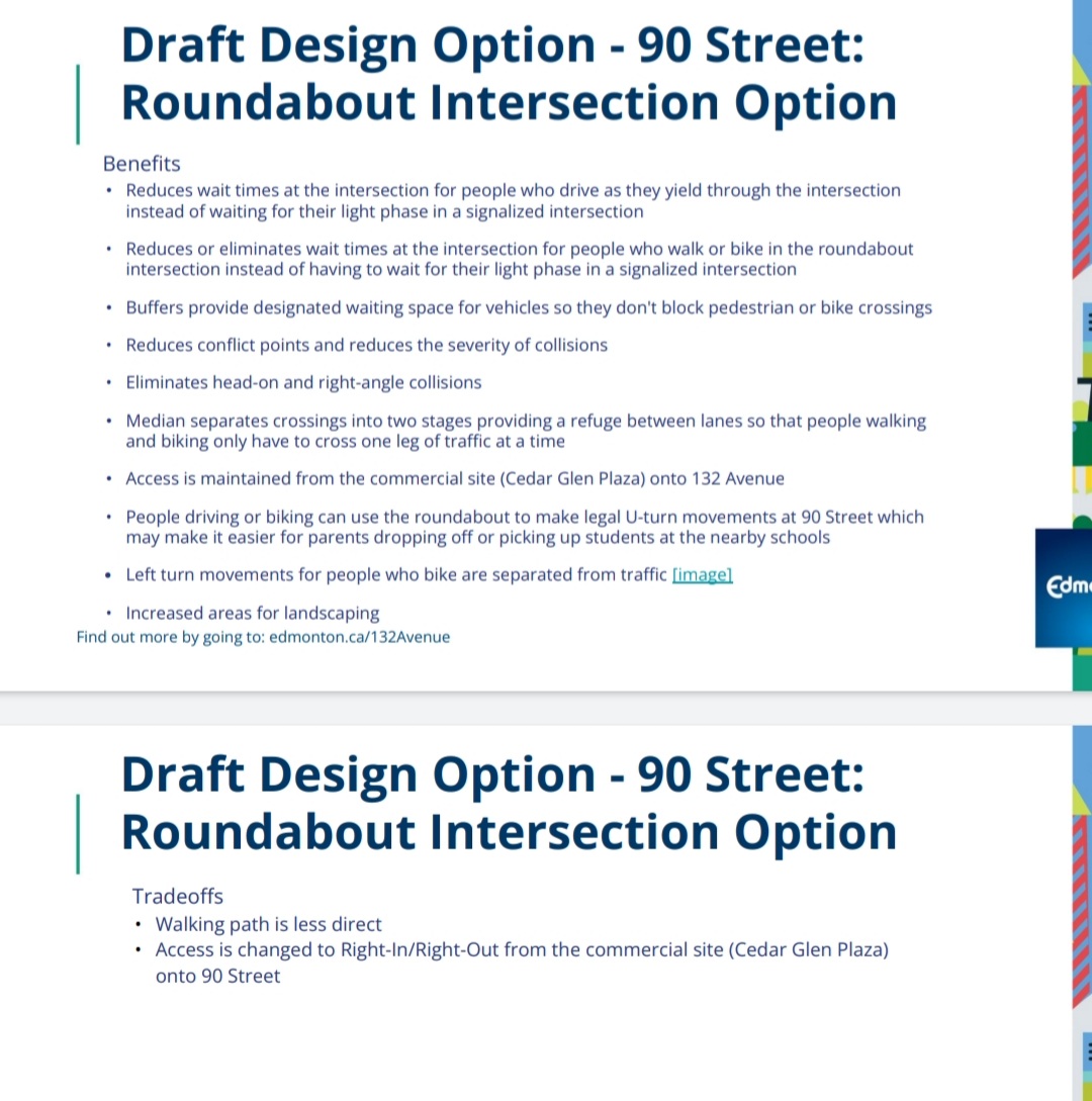

This is a proposed option for 90 Street and 132 Avenue. Yes, this is Edmonton! There are several schools along 132ave in this area including Queen E and O'Leary High Schools (I'm a Spartans grad!) So providing safe active transportation options like this znd traffic calming is right on the money.

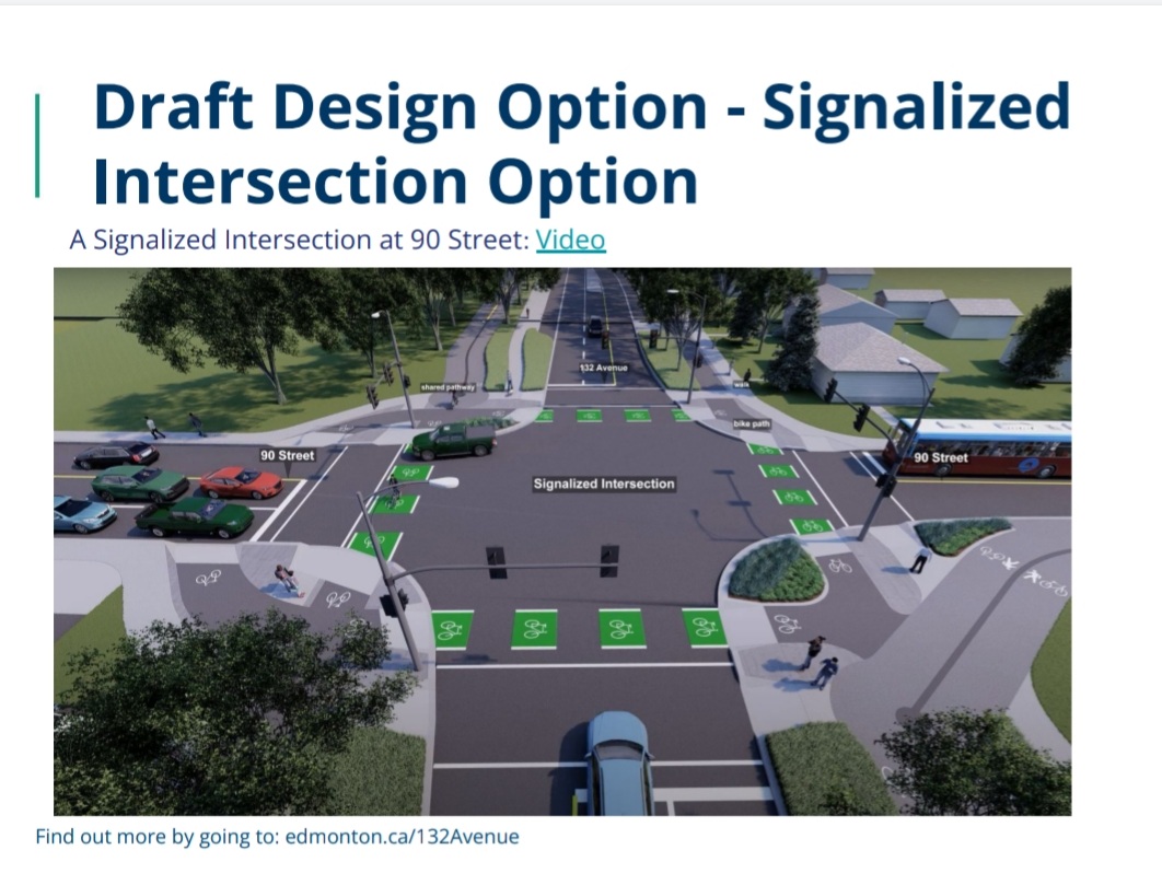

Here's the signalized version of that intersection, as well as the pros and cons of each option.

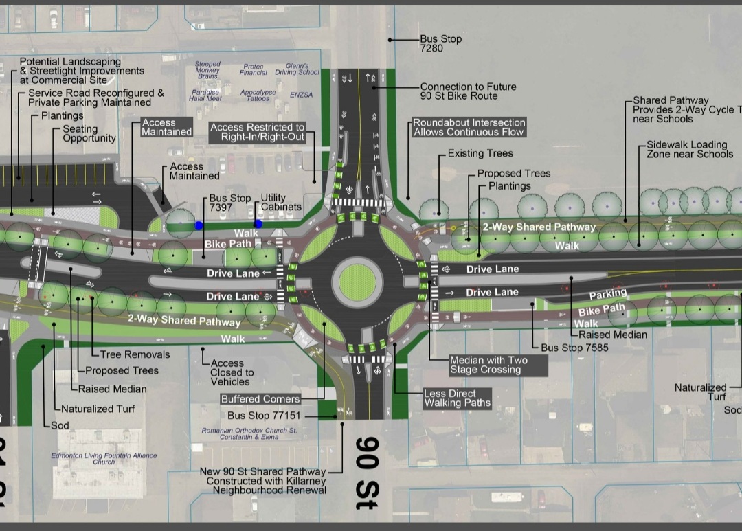

Lastly, I was a bit confused about why the bike lanes and shared use paths were shown to keep going down 90 street, since there aren't any there right now and I wasn't sure if 90st would be part of this project's scope. So here's the wider area context for each option (taken from the design booklet).
This would be a huge upgrade over the two current options of surviving a roundabout in a bike a) accept the fact you will dismount, awkwardly mon onto the sidewalk and waste 5 minutes. b) act like a car, claim a lane, hope you don't get hit from behind or turned into from the inner lane or by someone entering the roundabout right in front of you or...the possibilities of injury are endless and if you survive, get some angered drive to yell at you to get to the f... sidewalk.

I just want to mention that the streets shown in the images above appear to be wider than they need to be. Do we really need a sidewalk then a median and a bike path then another median than a road heading one direction then another median and a road heading the opposite direction then a median a bike path then another f*king median then a sidewalk. The roads are meadianed to death with wasted space that nobody is going to use, so much for reducing our ecological footprint... room for planters and benches!

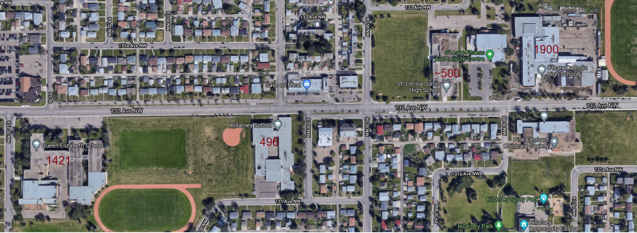

I went to high school on 132 Ave and I can say that the area is sorely lacking in sidewalk area at the moment, especially around the bus stops. I'd rather have sidewalks/bikelanes that are a bit too wide than grass that will quickly die and turn into ugly desire paths.
Here's a 1km stretch of 132 ave with 2 high schools and 2 junior high schools. I had to estimate the enrollment of the catholic junior high, but all together it's around 4300 students total. 4300 students mostly all arriving from 8:30-9am, typically in big batches from busses.
