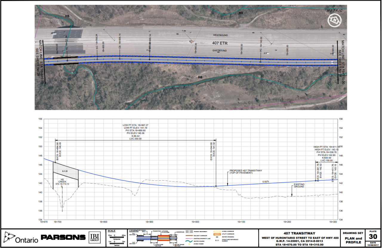

On plate 30 of the Graphics Package, the Transitway is directly next to the highway. Won't this create problems for future widening of the highway?

That stretch of the 407 is already at it's ultimate designed width - which is a massive 6 lanes in each direction. if you add more lanes than that you have to go to a collector-express system - which may be a bit out of budget for 407 ETR.
