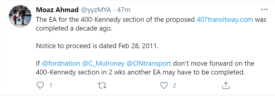

Moaz Ahmad on Twitter: "The EA for the 400-Kennedy section of the proposed https://t.co/I0FxxHR1ES was completed a decade ago. Notice to proceed is dated Feb 28, 2011. If @fordnation @C_Mulroney @ONtransport don't move forward on the 400-Kennedy section in 2 wks another EA may have to be completed." / Twitter

The strange part about this whole thing is that the current government approved the EA of the western segment of the Transitway a few months ago, meaning that this is a project they're supporting and are approving of. I find it strange that after approving one segment of the transitway, they will just let another segment have their EA expire, especially when that segment runs through areas that are historically battleground districts and building higher order transit infrastructure would bring a lot of political points in these areas. My feeling is that if they don't announce the start of construction within this timeframe, either they will count on using their "ignore EA time limit clause" that they're somehow using with the Bradford Bypass, or they're planning something else, such as a REM style project between Kennedy and the 400.
