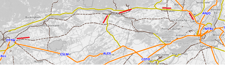

If you went through Bayview, you'd need I think 9 grade crossings in Gatineau if you closed some grade crossings (or else did some short tunnel or trench sections). But those grade separations have to be done anyways if you ever want to extend the trillium line into Gatineau, so there's good value there.You don't go through Gatineau or the Senate. Although some earlier studies proposed using what are now O Train tracks and across into Gatineau, that would entail a new station at what is now Bayview and scores of grade separations. I think the door is closed.
I do like this route too though.I'm talking about a route as outlined below in red dashes, using different ROWs. I think it's vanishingly unlikely. For example, I figure you would need a 3 km tunnel under Hawkesbury and the Ottawa river. At the end of the day, it's not really a longer or impossible route, assuming you can connect Gare Central to Parc with a new tunnel.View attachment 699021
