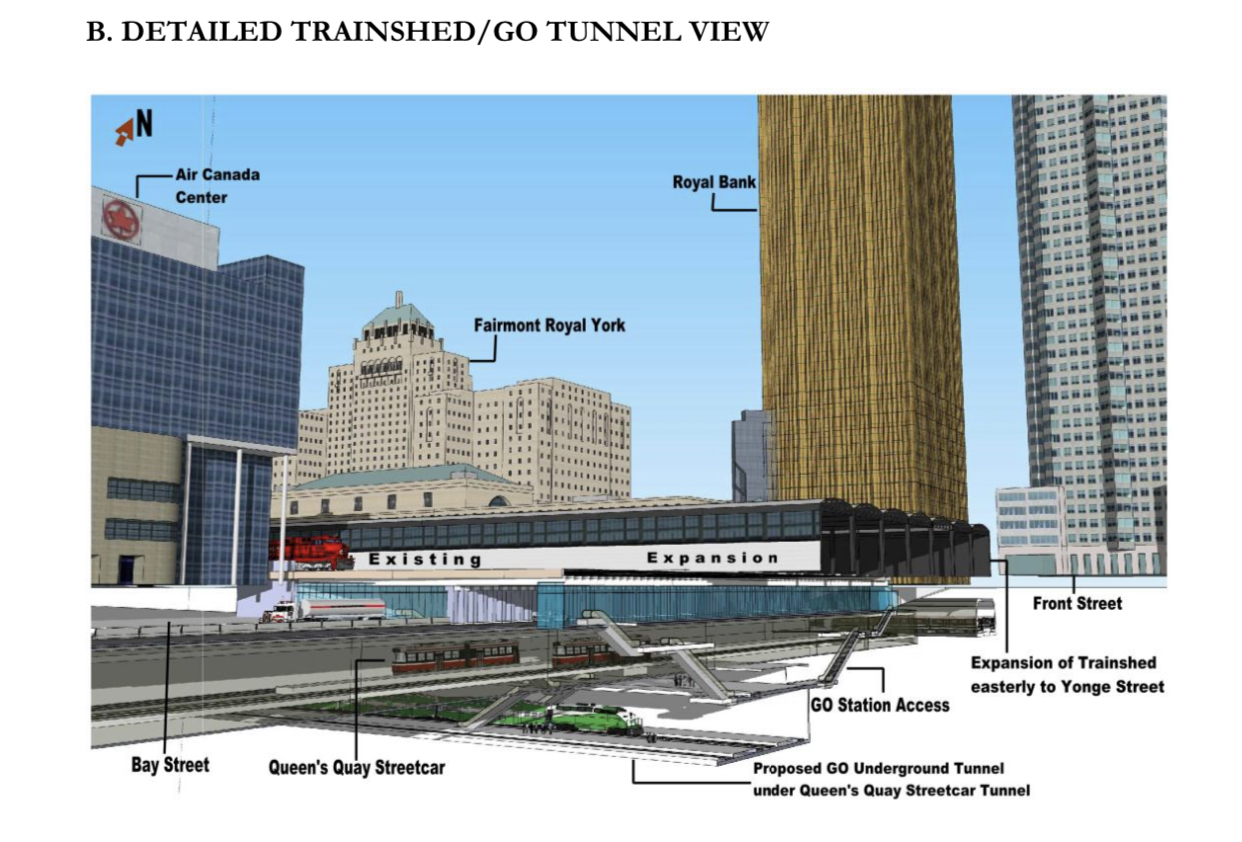

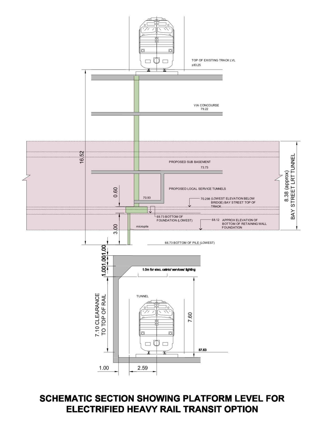

I see a decent bit of talk about an underground platform at Union. I understand the capacity constraints of USRC but I also think any underground routing would be incredibly challenging.
There are so many obstacles to navigate heading northeast (foundations, OL and existing subways, Coxwell bypass, several waterways and sharp terrains). I really can’t picture where a new portal could even be built, which leads me to think we’d need a very deep tunnel stretching at least 10-15km before there’s a suitable location to emerge.
I’m interested to hear ideas.

Not impossible, but the stations will certainly have to be deep.
It's not high speed rail, but look at London's Elizabeth line for reference.
It’s been deemed technically feasible before when Metrolinx studied it, just not cost effective over upgrading the existing platforms for the then-named GO RER project.
