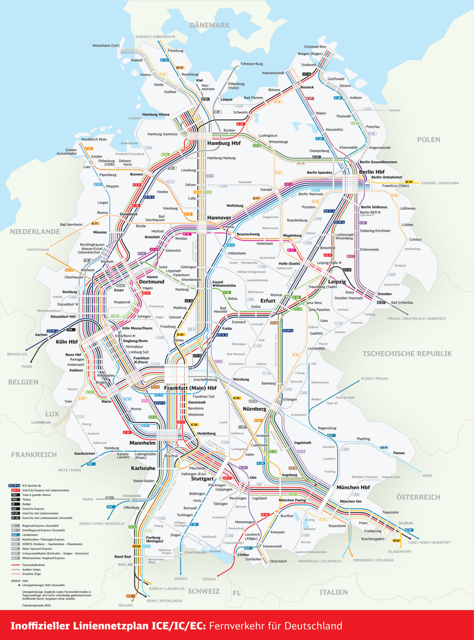

You may want to count the number of ICE stops in cities like Munich, Frankfurt, Dresden, Cologne, Basel and especially Berlin or Hamburg:
Here a fairly typical example with 3 stops each in Hamburg and Berlin:

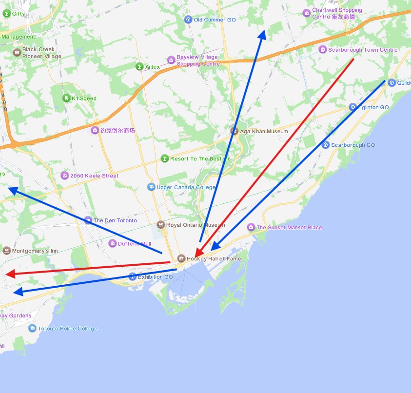

The way that I see it, Line 1 is already at-or-over capacity at times, and adding more lines into Union is going to exacerbate this issue more-so if we're not upgrading the local (TTC) or regional rail (GO) from Union, especially if those HSR travellers are heading north on Line 1 - GO is not a resource for people living in the city and is mostly for suburban travellers. We can alleviate this issue by having a more Northern HSR station that ties into both GO and TTC.
The Beijing example works because there are multiple modes of frequent train service at all stations connecting to all other stations in a variety of directions. The problem with the Union proposal is that it drops everyone into one place which, yes, is a central station and does have service to elsewhere, but it provides a central chokepoint for the entire system as well, dropping people onto local transit which is generally overwhelmed at best and unreliable at worst. What's the alternate scenario if it was similar to this past weekend where there's no subway service b/w St. Andrew & St. Clair West?
Are there any other examples of large cities which have a water barrier on one side preventing service in all directions from it? If this city exists, is its central station against that water or is it moved away from it to provide better coverage? Tokyo is kind of similar but it's more of a ring, so Tokyo Station isn't really comparable to Union as lines can still spread out accordingly. Marseille might be similar but that city has half the geographic footprint that Toronto has and only half the population.
Additionally, from a city design standpoint, I think there's a lot to be said about Toronto's general sprawl with a defined downtown core, which is dissimilar to Asian examples which are more dense throughout. Just as sprawly but with far more density. If Toronto is serious about densifying more than just its downtown it needs to begin providing transit options to people outside of the downtown core, and this is coming from someone who can walk to Union in 10 minutes.
I can leave it to the experts here (genuine) to discuss rail lines and where a more northern HSR station could be planted instead, but it wouldn't bother me at all if ALTO Station was located on Eglinton or at Kennedy, as long as there are local transit options to get me downtown from there. I think my overarching issue is that I don't trust local transit connections to keep pace with a new HSR station, and thus we'll be exacerbating an already-bad situation regardless of where the station ends up. Alternatively, perhaps the clientele we assume will be using HSR is so specific that only a stop at Union makes sense.

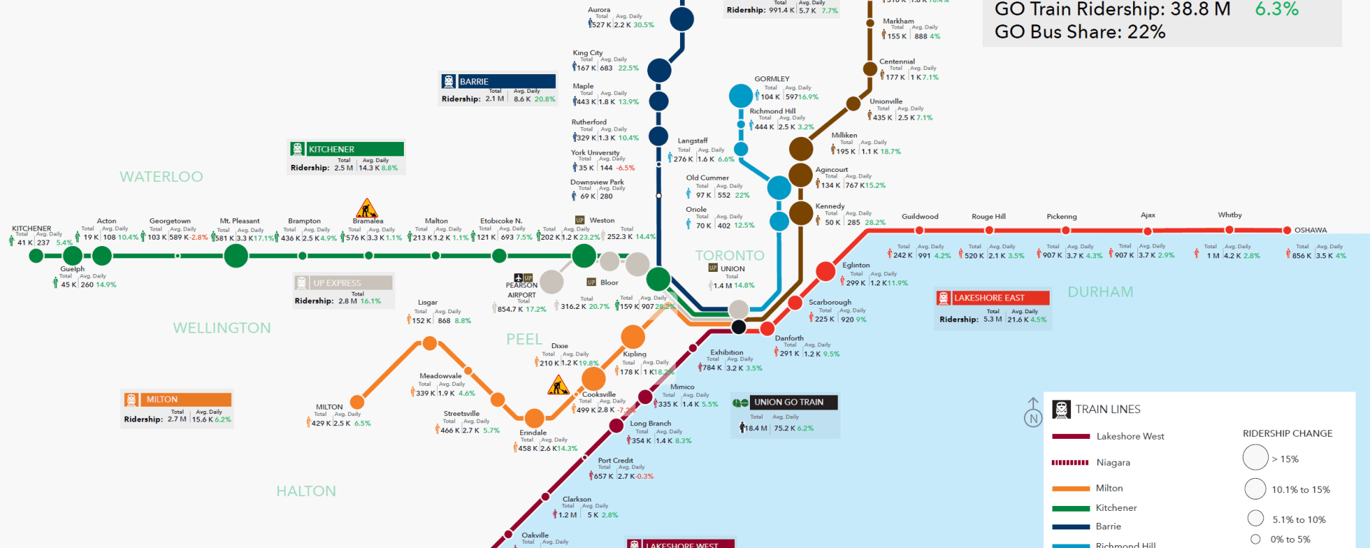

The last comprehensive station by station ridership numbers I recall are from 2019
From the above:
Annual/ Daily
Guildwood: 242k / 991
Oshawa: 856k/ 3.5k

Thanks! That's GO ridership, I was also wondering about the VIA ridership to points east.
