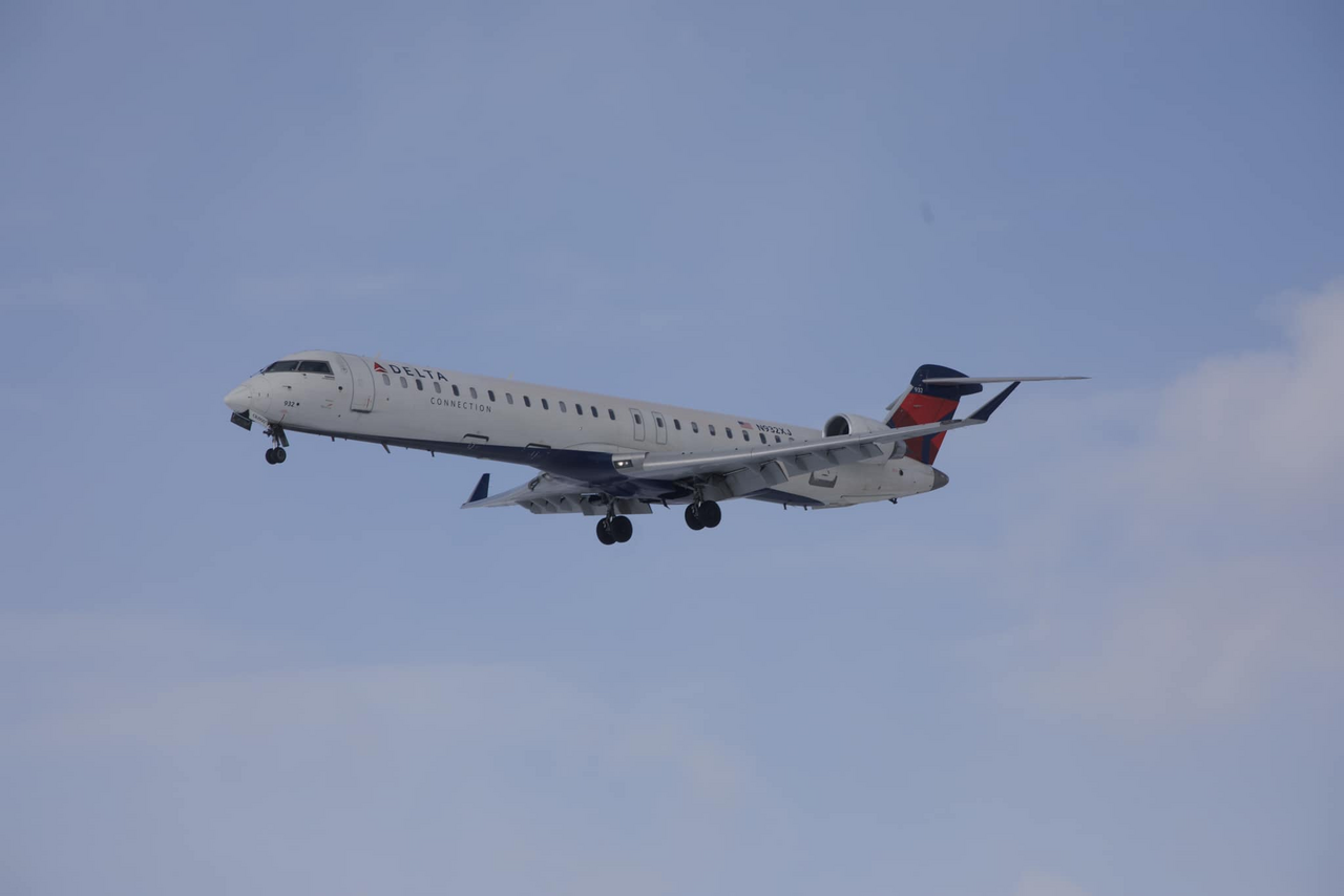

Assuming this image from the Toronto Pearson thread is as accurate as described, it looks to be properly configured.
This shot was from Jerry Yang on facebook right before the crash and the gear is down:
