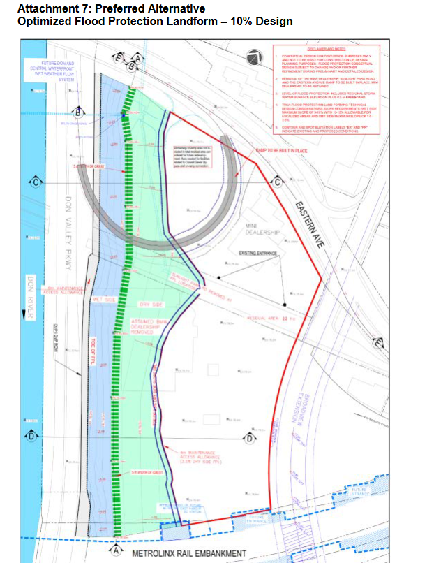

The design has been tweaked since this, but I had quick access to this:
This scope has changed since the DVP/Gardiner transfer to the province. The “re grading scope” was working around the BMW dealership, however due to the transfer, the land is being expropriated.
The BMW dealership will be demolished and the grading will be continuous
Yes I believe that information was posted in another thread. I will see if I can dig it up.

It’s a very interesting project to say the least, with the politicking between the Province/City/Talisker/BMW. The Old Eastern Ave Bridge demolition is also a part of this project, however even finding funding for that scope has delayed that portion over a year
The flood protection design is based around an embankment with a clay core that has very low porosity, to the point where no one is entirely sure it will be available at the time of construction, where a 30%/60% backup design needs to be carried “just in case”
