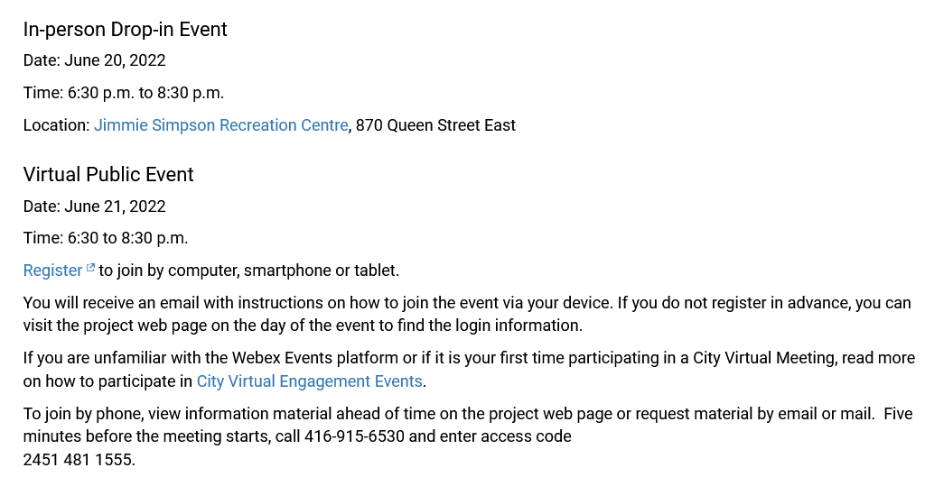

In relation to the above, the presentation deck isn't up yet.
However, info on an in-person consultation date is (we're doing those again!) plus a virtual one; along with a link to the survey.

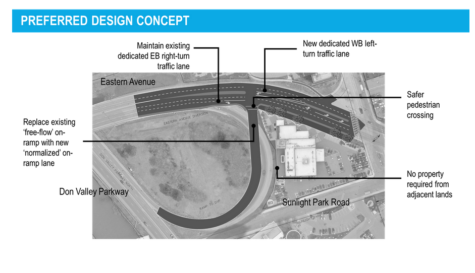

Next the survey moves on to look at one change to the Eastern Avenue/DVP Ramp:
This is certainly an improvement over existing, but my challenge here is that I know this is part of a larger reorganization of that entire set up, along w/Richmond/Adelaide and I want to see the overall design
and how it works together to comment intelligently.

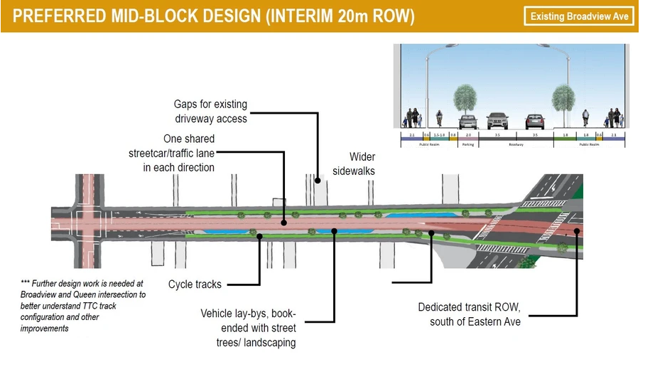

This is the interim concept for Broadview from Queen to Eastern:
Not a fan whatsoever of the Broadview from Eastern to Queen segment. That's going to be a complete traffic disaster which is going to result in terrible travel times for streetcars. The sb direction gives a dedicated lane at the intersection for streetcars but it doesn't even look long enough to fit an entire streetcar.. why bother? It'd be better off left as it is today. Definitely get rid of the right turn merge lane southbound onto Eastern, add a southbound dedicated streetcar lane approaching Eastern, and narrow the lanes to modern standard widths, but I would otherwise leave it as is.
I don't hate the Richmond / Adelaide ramp realignment, mainly because it allows for westbound access to the DVP from Eastern, which is a key missing movement right now.
Laybys are necessary on Broadview as people will inevitably be trying to do curbside drop offs at the station. The road won't function at all otherwise as people will be blocking traffic to perform drop offs without them.
I'd be supportive of reducing them to more strategic drop offs with wider tree planting areas on parts of the street instead of a continuous curbside lane, but given the densities here and proposed commercial uses anyway, I suspect demand for curbside layovers is going to be extremely strong in this area.
If the eastern - dvp ramp is going to be modified like that ... does that mean they are removing the queen - dvp ramp ?
That should be the last ramp removed. It's by far the highest volume DVP ramp from the core.
While in my Utopian fantasies I would prefer to remove the DVP entirely, I recognize pragmatically that may never be on the table and certainly isn't now nor in the foreseeable future.
That being the case, @innsertnamehere is entirely correct that Eastern as a ramp pretty much has to stay. Whereas the other access points to the north, up until Bayview/Bloor can be seriously considered for removal.
Bayview/Bloor can and should be modified substantially, but must likewise remain if the DVP is staying.
In all my years I don't think I've ever once taken the Eastern-DVP ramp. Certainly a bit hairy for those who do with the tiny merge onto DVP n/b. Broadview will be interesting whatever is done. The makings are there for it to become one of the greater streets in the city. I do have a bit of trouble wrapping my head around how it will have its own LRT, but also carry the 504 which is the busiest route in the city, and the 505 which is likely in the top 10. How will all those converge and terminate at Broadview, rhetorically speaking.
It's a speed trap there. Eastern looks like a highway through that section and cops love to nab those goes 70+.
It's the better ramp out of there others nearby. Both Queen and Dundas (especially Dundas) would hold streetcars while cars make a left to get on the DVP.
