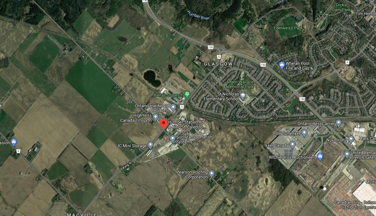

The proposed GO Station for Bolton would go here, at the north-west edge of town:
The Red Marker indicates the intersection identified in the press release. Clearly the station would abut the tracks.
While useful for parking, I would have liked to see a station that would be more easily served by high quality transit, perhaps at Highway 50.
