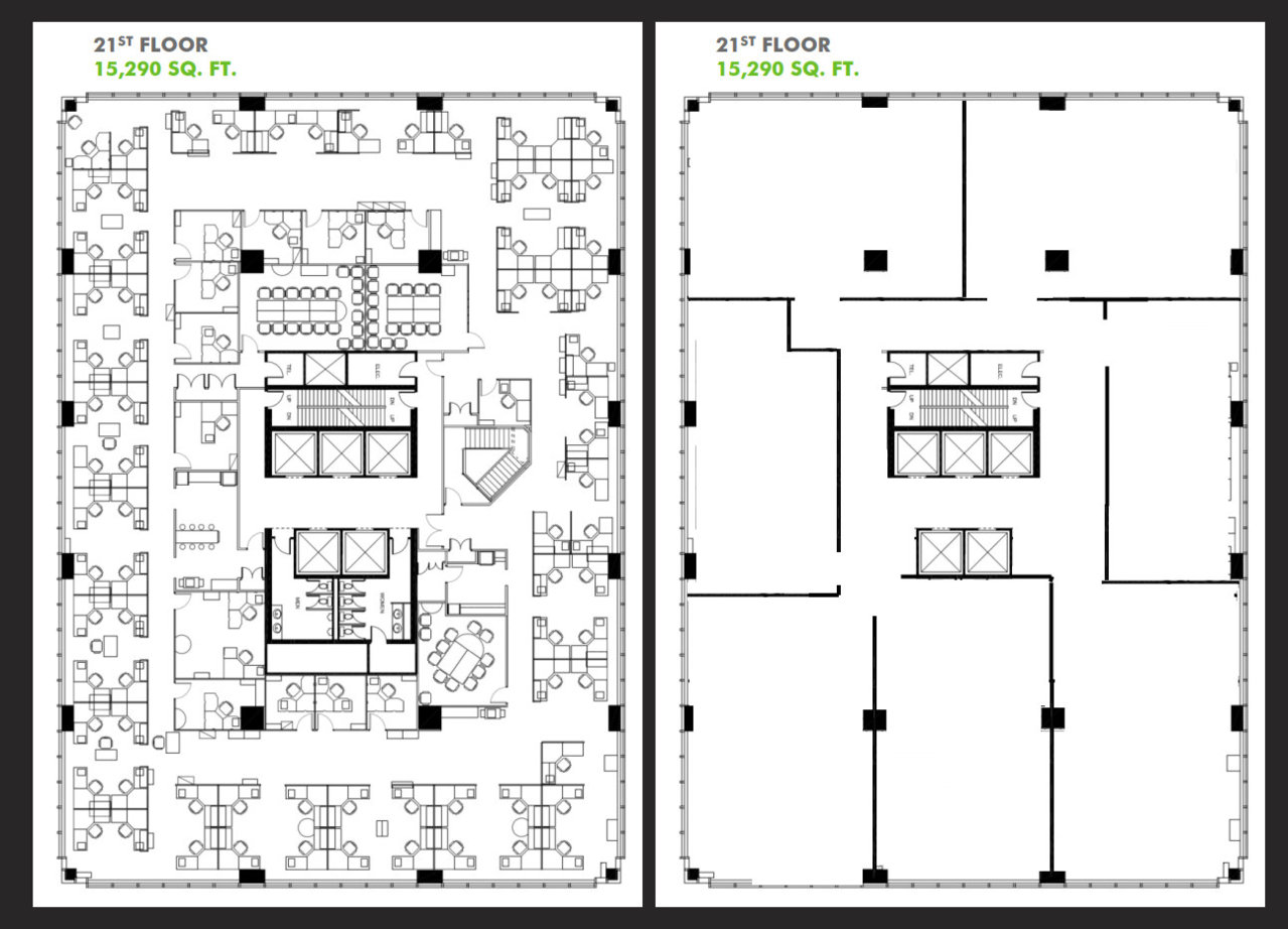

I'm still a big supporter of the idea of office to residential conversions for a few reasons...one of them being the tax base in the CBD needs to be more diverse, and also just to get more people in the CBD. It'll be interesting to see how this plays out as the office vacancy rate doesn't look to be changing anytime soon, and owners may look at alternate uses for the space. Residential seems the most obvious and would be a win win solution, but the issue is with the conversions itself. Small buildings are doable, but the larger buildings.....the ones that would be great (Bow Valley Square, Metropolitan Centre, 5th and 5th, The Edison, etc..) to convert are difficult and costly. A lot of it due to building codes. Maybe that can change, I don't know.
True, true. You get units with weird floor-plans and most office to residential units don't have balcony's as you have to alter the building envelope.
Floor plans are tricky for larger spaces for sure. Here's a quicky example of what I thought could be done with say, 5TH and 5TH. This is very rudimentary and not architecturally correct but gives an example of how floor space could be divided up and given to purchasers as bare bones space. Plumbing and electrical would have to be put into each suite. Right ow the building has 15K floorplates, and could be divided into 7 lot or 8 loft spaces that would be between 1,300 and 2,000 sq feet. Pretty good chunk of space to work with.
Right now as an office building it's renting at $21.00/sq ft. If the market stayed stagnant for an extended period of time and the building was half empty and renting at half that, the numbers may start to work. Rent the building for $10.00 a square foot for ten years or sell the space as is for $100.00 a sq foot? A 2,000 sq ft space for $200K would be very appealing for someone who just wants a large loft space, especially a young guy who would be happy to throw in a bed and some kitchen appliances. Costs would change with the plumbing and electrical, etc.. I could see people making them into large bachelor or one bedroom suites. One of the problems is the building codes. You could use the space as is and throw a bed and some kitchen appliances in, but not without having to change things to meet the building code.

Running water, drains and ventilation (all required for residential) is not easily done where there was none before.
For sure. Running water generally shouldn't be a problem except for a kitchen island. Drainage is tricky, but a possible workaround for the drainage might be build the bathroom floor up one step, and given the high ceilings, losing room height wouldn't be an issue Not ideal of course, but could work. ...assuming all the bathrooms aren't far from the main stack. Another possibility is to bite the bullet put in a stack that would be shared be two units, you'd be looking at 4 or 5 stacks. It's more cost of course, but allows for more design options. Ventilation is work, not to mention new heating and AC units for the building. Still...I think it's possible if the numbers get to the right spot ...and the building codes can be adjusted.
