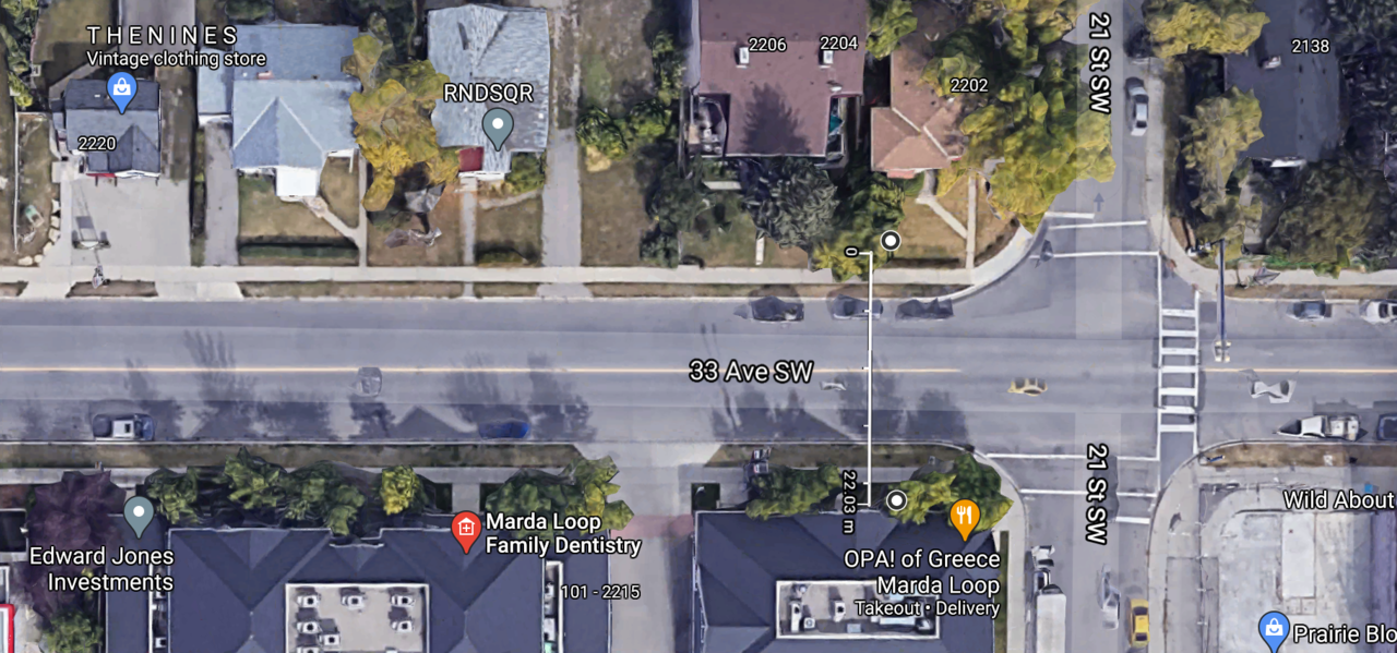

Measuring it considering the public realm in front of the ARC building proposed, looks to be a minimum of 22m ROW width. View attachment 299416
In my opinion the 22m building is perfectly scaled for this type of ROW as the building height to ROW width is perfect to create a human scaled street. What do you think is the optimal height and public realm and why?

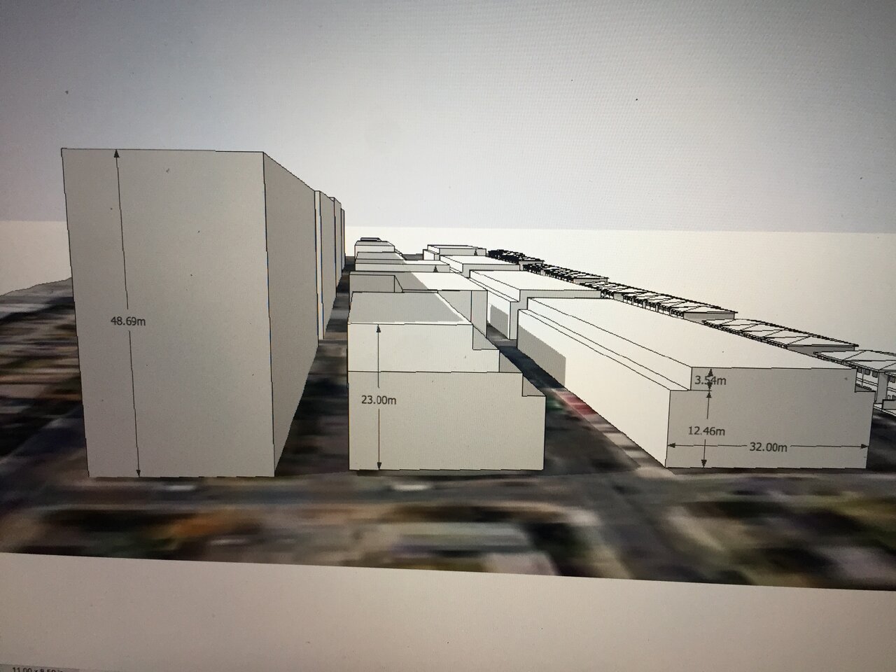

Yes, we were pushing for the greater heights to be along the north side of 34th, and our shadow studies showed that a building in that location could be 48m tall without creating more shadow issues on 33rd than a severely stepped back 23m building on the south side of 33rd.
The streetside half of the buildings on the north side of the street could increase in height and have no additional shadowing impact.
The one difference would be that there are houses in behind the buildings that would be on the north side of 33rd, whereas there are more buildings in behind the buildings on north side of 34thave. That said, 4 storeys on the north side of 33rd shouldn't be a shadow problem. Maybe even 5 storeys.
The image already shows the north side of 33rd at 4 storeys. A couple extra storeys on the southern half wouldn't increase shadowing on the single family. The precedent is already set though with Courtyard not having a northern setback, and 6 storeys a shade under 22m.

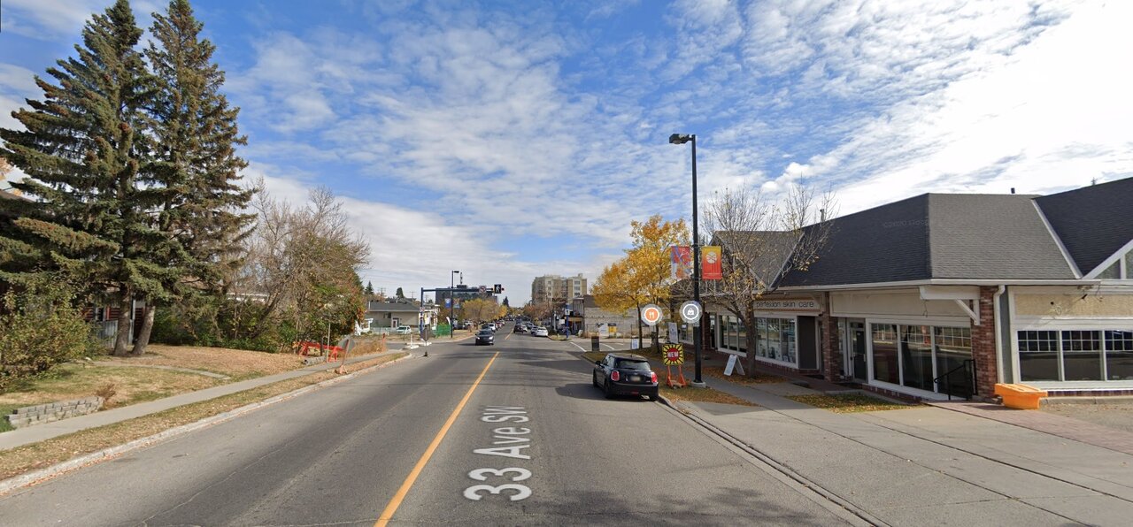

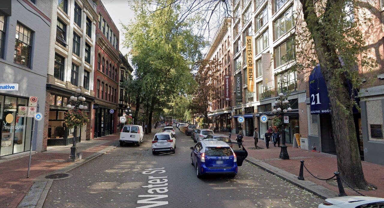

In terms of the impact of the height on the vibrancy of 33 ave, I simply present exhibit A and exhibit B:
Couldn't agree more brother. There's pretty much northing quirky about 33rd. There's more quirkiness on the 2 retail blocks along 34th than on all of 33rd.
Also, I know we've all complained endlessly about the street design in Marda Loop, but I just have to comment on how pathetic the lighting is along 33. I see just two highway-style lampposts in the first picture. Given how short daylight is in Calgary during the winters, I'd say proper lighting was far more important than shadowing in raising the appeal of our main streets. I mean, just look at the lighting in the second picture!!
