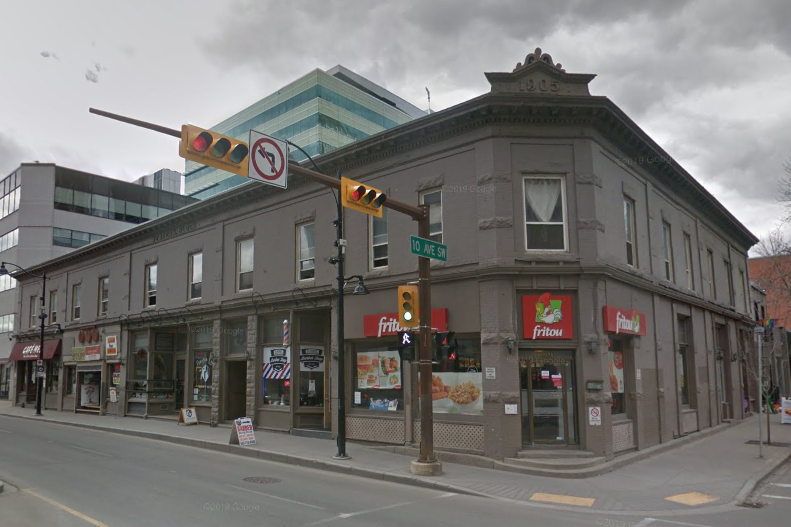

Broken record alert for all my other sidewalk complaining posts - if this development does anything good, my number one priority would be to fix this abomination and anti-pedestrian disgrace of 1 Street:
Again, on what must be the narrowest sidewalk, on one of the busiest pedestrian streets in the city:
  • Why use 1 pole when you can use 2?
  • It's okay if a signal pole's gravity base takes up over half the right-of-way, right?
  • Hey, turns out we actually do have a bit of extra room in the right-of-way - perfect, lets add some pointless decorative poles with banners and a median!

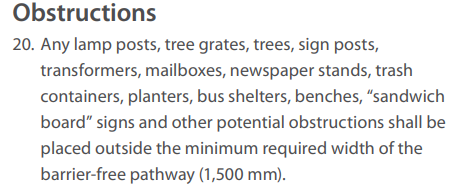

From the city's own access design standard's guide below. Do we think that distance between the first pole and the building is 1.5 metres? Remembering that 1.5m is the bare minimum recommended width.
It's just really weird that we need a $50M+ tower development to trigger fixing an obvious sidewalk barrier to accessibility and pedestrian mobility on the busiest pedestrian streets. We didn't seem to need $50M+ of development to create the barrier and install these poles with these designs in the first place.

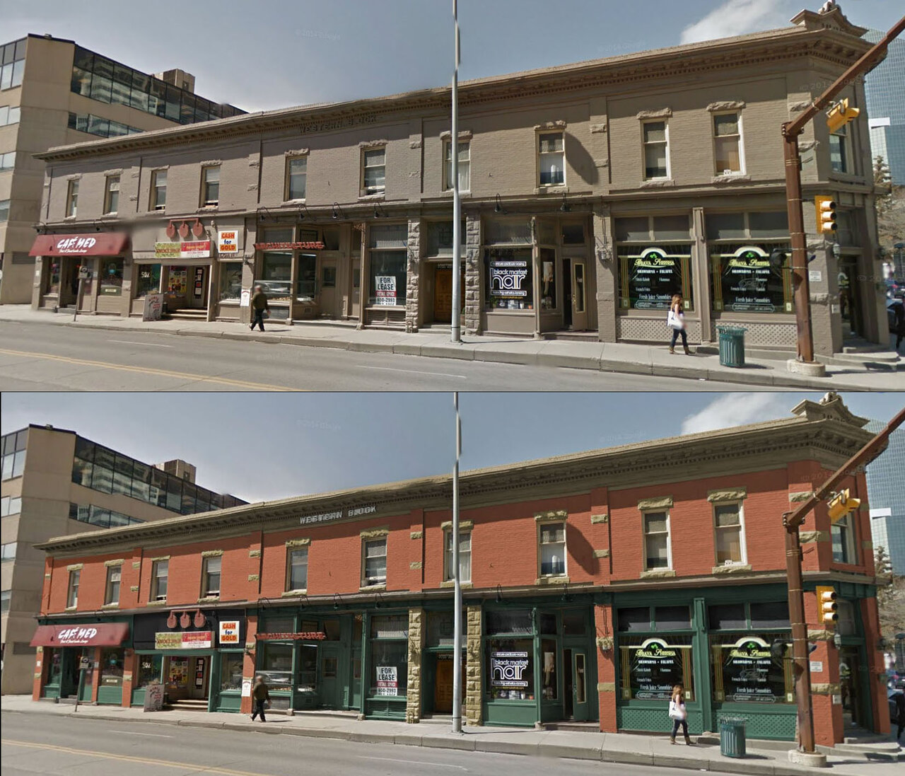

I'm assuming it's a brick veneer on a wooden structure opposed to a brick masonry wall. It can't be retained while the rest is demo'd. The site is too narrow to provide a needed buffer between the tower and a replicated Western Block facade. It would just look silly.
It's not structural masonry for sure, I don't think we have any of those buildings in this city. If they chose to reuse the brick, they would disassemble the building keeping all the brick, then just use them as cladding on the new structure set a couple meters back. Wouldn't be hard. The question is whether the brick is even worth keeping, hard to tell under the many layers of paint.
It's not hard. Very time consuming and expensive. New brick allows the facade to be adjusted to the floor heights of the new structure
