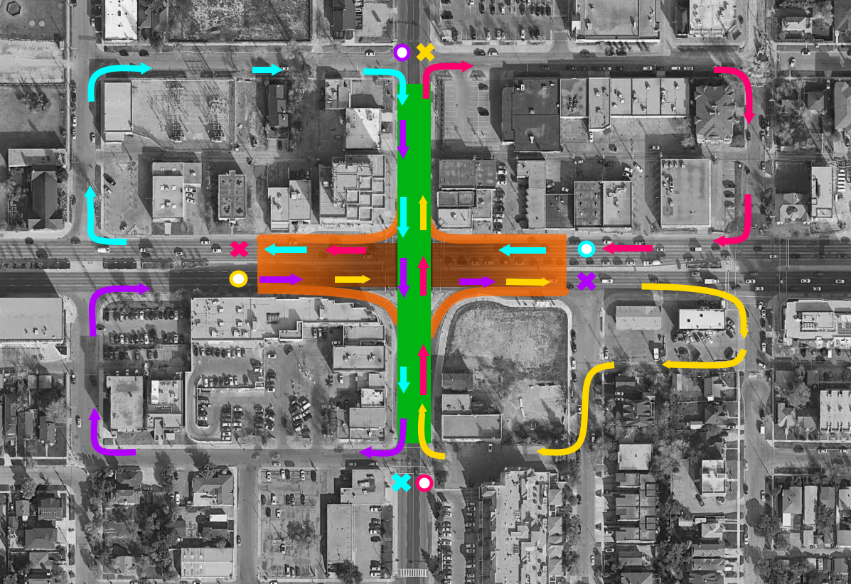

If we made 16th Avenue go under Center St like I proposed, you could arrange the turn movements as follows:
It would be a pseudo-interchange, working similarly to how WB Memorial turns onto SB Crowchild right now. You would need to sign it well (and expropriate some parking lots to make the yellow path work and be wide enough) but it would come with some significant advantages:
  • No lights at 16th & Centre St. Period. Through traffic going N/S on Centre St, or E/W on 16th, never has to stop. This removes a major bottleneck in both roads. It might even improve the flow of traffic so much that removing that lane of traffic on Centre St for the train hurts way less.
  • All previous left turns replaced with a series of rights. So left turning traffic never has to wait at a stop light. Even though a little extra driving is required, it still saves significant time versus waiting in an intersection for a couple minutes for the light cycle to go your way.
  • Great for pedestrians and cyclists too (could have pathways along both roads, no waiting at lights, only traffic they need to contend with is right turning traffic which must yield to them)
  • Green line doesn’t get delayed by any stop lights
  • Green line station can be built above ground (significant savings) on either side of 16th.
  • Left turning traffic never crosses the green line tracks

I really doubt that, what are you basing that on? An underpass like I proposed would probably clock in somewhere around $150M based on comparable projects in Calgary. The cost of tunneling (plus stations!) is far more than that.

I appreciate you thinking out of the box to find a way to keep traffic moving at this intersection, but I’m not sure those side streets adjacent to the intersection are built for the increased traffic proposed and I’m not sure people who live along those side streets would be too pleased with the increased traffic either!

This is creative but it's the type of project that would undercut everything that the a major rapid transit project needs to do.
You don't "need" to preserve all these turn movements and create a weird in-neighbourhood cloverleaf interchange, that would require all sorts of strange land acquisitions and create traffic, speed and safety issues into the neighbourhood - the same place you are trying to increase land use intensity and walkability. You are working against yourself in the name of "balancing needs" when the output cannot be balanced because improving car capacity and transit/walking quality/land use intensity require the opposite things to be successful. It's a lot of extra effort and long-term downsides that counteract the primary investment of a rapid transit station about 5 minutes from the City Centre.
To adapt this idea for a future Green Line phase I would restrict and reduce the level of service for all turn movements at Centre and 16th Avenue. To compensate, create a cut-and-cover station at the intersection would provide several multiples of capacity increase in the N-S direction, meaning you can reduce Centre to a 2 lane road and still see the corridor's capacity grow several multiples. 16th is primarily E-W movements, so a reduce need for N-S cycles will allow for greater throughput here and removing the redundant turn infrastructure means less intersection complexity, accidents and congestion.
