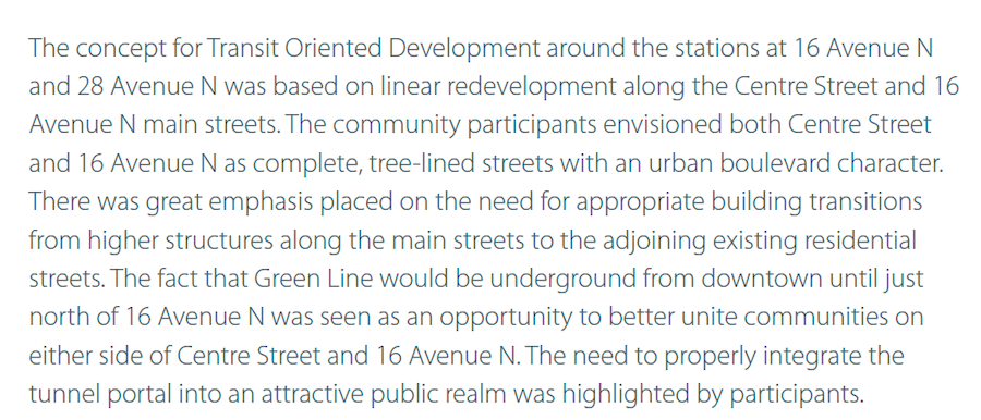

I don't think the idea of the segment from the Bow to 16th Avenue being underground is purely about about NIMBY or about not affecting traffic. Replacing vehicle traffic was supposed to improve the Centre Street urban landscape, such as:
The Green Line isn't going to be some quaint street car that's only 20 m long and puttering along at slow speeds, if it's successful it's going to be a 125 m long train with 150+ m stations. Two stations at-grade will prevent significant sections of Centre Street from even seeing across the street, and several intersections will be blocked off. And with the limited space in the area, transfers to/from buses are going to be a hassle.
And the final issue is that since no segment has been confirmed as the next stage, losing two lanes may in fact cause massive traffic delays that won't be resolved for another 10, 20 years. The irony is that car drivers will probably be able to adapt better than the many dozens of buses per hour that use it today.
- Correct, the communities had big concerns over tunnel portals and how they are several hundred metres long and divide the community. Keeping the train on the surface eliminates one, possibly two tunnel portals (assuming the train was just to be buried under 16th Ave) and actually does a better job keeping the communities connected.
- Several intersections being blocked off to accommodate the stations is a car problem for local traffic only, not a pedestrian problem. Given the low floor trains, the station platforms are essentially sidewalks and pedestrian crossings can easily be created between the station platforms and the sidewalks. The communities wanted a walkable main-street. Having several intersections blocked to vehicle traffic is actually an improvement over the busy 4 lane street that exists there today.
- Agreed that if Green Line never proceeds past 16th Ave, then the current design might cause issues but I would argue that the project is meant to be phased and each phase must be looked at in the context of the entire project. We shouldn't be spending hundreds of millions of dollars over-building each phase because we are worried the next phase may never happen. That becomes a self-fulfilling prophecy at it makes each phase so expensive, the next one becomes harder to deliver.
For example, we could spend several hundred million dollars burying the train under 16th in case the next phase is never built or we could actually use that same money to build north to 28th Ave station. Now that we're building further north, the concerns we were over building 16th Ave for start to dissappear. But maybe we should overbuild those next few blocks and extend the tunnel a bit further in case the project stalls out at 28th Ave but the extra cost of doing that means we could probably extend the line to 40th Ave. That's essentially what the Twitter thread I quoted argued. Instead of increasing costs by over-engineering their rail projects, European cities are plowing those savings into extending their rail networks and the momentum builds on itself. In the UK and in North America, we plow the cash into over-engineering which limits what we can build, which limits the positive outcomes it generates which means the next phase is more expensive and the outcomes are also just as limited and so we end up killing project momentum. If I had to choose between a tunnel between Eau Claire and 20th Ave or building Green Line on the surface from Eau Claire to 64th Ave, I'll happily choose the option to build it to 64th Ave every time.
