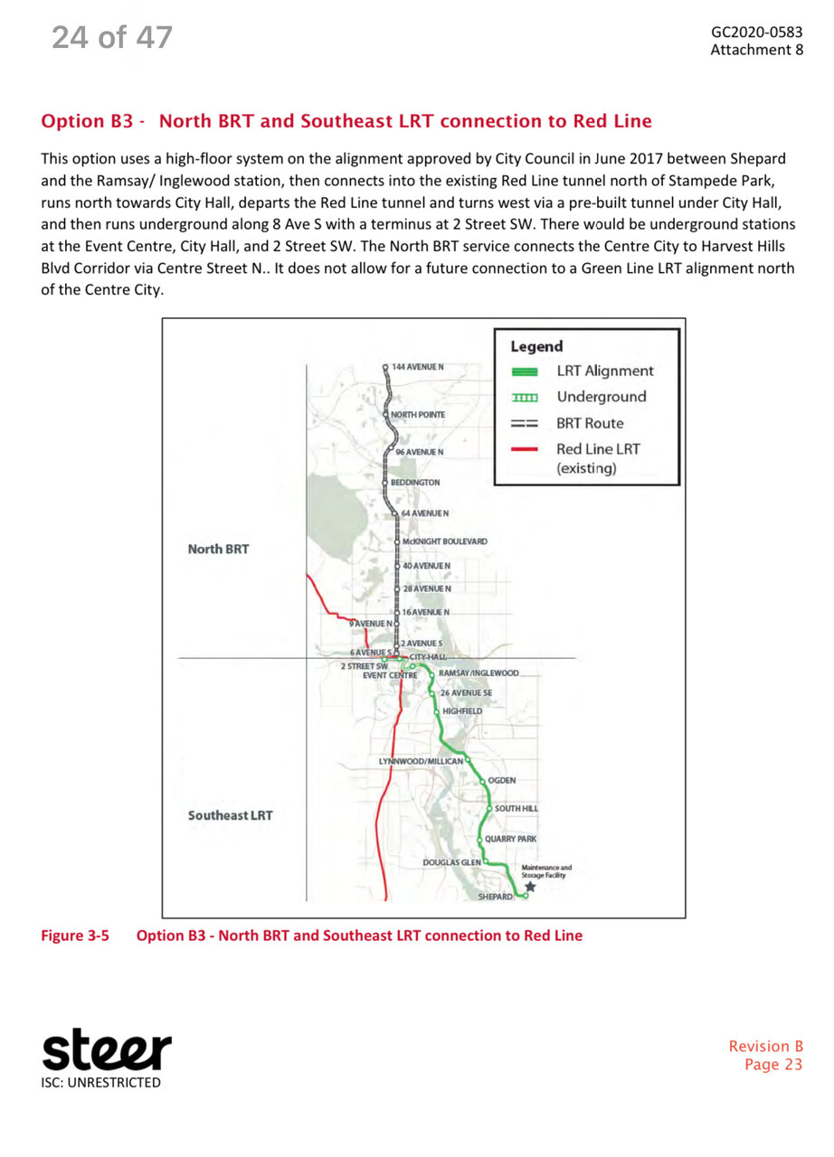

For the elevated line discussion, from reading the Alignment Options document from 2020 it appears that for the non-tunnel options they don't require NC and SE to connect which would simply things a lot. The elevated option presented won't even have the SE line cross the CPR tracks:
I can't help thinking this is one of those deliberately bad options that gets included in proposal reports to help guide the decision makers to the consultant's preferred choice.
It's not really a transit network if the lines don't connect or interconnect..
In this scenario, could the NC line go all the way to Calgary Tower and then somehow punch through an underground or elevated and covered pedestrian pathway from a Calgary Tower NC line station to a Green Line station on 10 Ave and Centre Street? Not ideal but I recall making quite a lengthy connection between lines in NYC via an underground pedestrian pathway. Just my two cents worth and I have no engineering background so feel free to give any feedback you wish!
