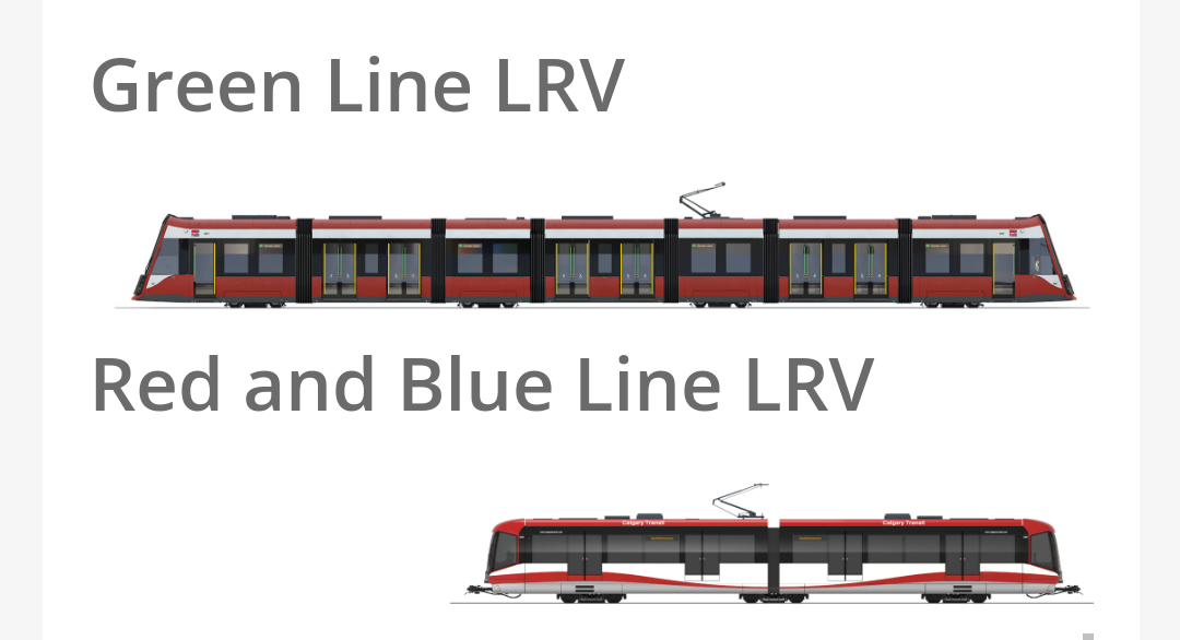

I genuinely don't understand people's obsession with the need for high floor cars... 2 Urbos LRVs hold more people than 3.5 traditional Siemen's cars. Do people just think that because the interior of something looks like a subway car it must have the capacity of a subway car? The whole fleet commonality thing is a head scratcher too because Calgary Transit doesn't operate a common fleet now. There is literally nothing in common between a S-200, a S-160 and a U-2. It is three very different types of trains so adding 1 low floor LRV to the fleet has zero impact on any sort of imagined operation savings. The fact the premier has seized on this vehicle argument shows she has spent less than 1 minute actually learning about the issue which should concern all of us.
That's a fairly disingenuous argument, it's not like the low floor cars have some sort of magical super-density, they're significantly longer!

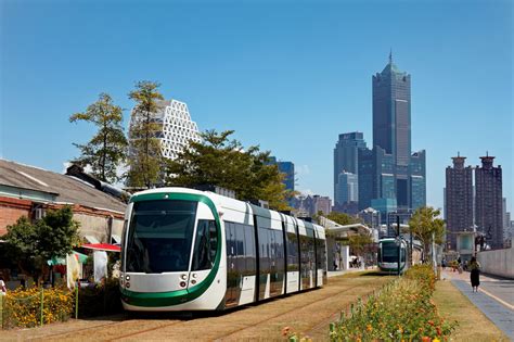

One thing I've noticed with the low floor train in Edmonton is how the overhead wiring really ruins the the streetscape gains made by using smaller curbside stations.
While Kaohsiung's LRT uses the same Urbos 3 cars that Calgary ordered for GL, theirs are powered by super capacitors that charge at the station. I'm guessing that technology doesn't perform well in winter conditions, which is really unfortunate as the difference in visual impact is significant.
Compare:
With how GL would look running at surface down Centre St.
Compare:
I don't see it as a disingenuous argument. The low floor LRVs are longer because low floor LRVs are designed to be modular where length can be adjusted easily depending on what the customer wants. To my knowledge, there are no high floor LRV designs that are comparable and so making a longer high floor LRV for Calgary would require a very specialized (read expensive) order. Just another reason why going Low floor made sense for Green Line
I don't see it as a disingenuous argument. The low floor LRVs are longer because low floor LRVs are designed to be modular where length can be adjusted easily depending on what the customer wants. To my knowledge, there are no high floor LRV designs that are comparable and so making a longer high floor LRV for Calgary would require a very specialized (read expensive) order. Just another reason why going Low floor made sense for Green Line.
OK, well if modularity is the argument, are the shorter LRVs not inherently more modular?
For instance, a low floor train with two of the loooong LRVs has a collision at an at-grade crossing with a dump truck. Bam, half of that train is now out of commission, whereas if a similar collision happened with a train made of four of the shorter LRVs, only a quarter of that trains capacity is lost.
For normal operations, the shorter cars could also offer more flexibility for train size at low use times of day, saving wear and tear on the LRVs.
