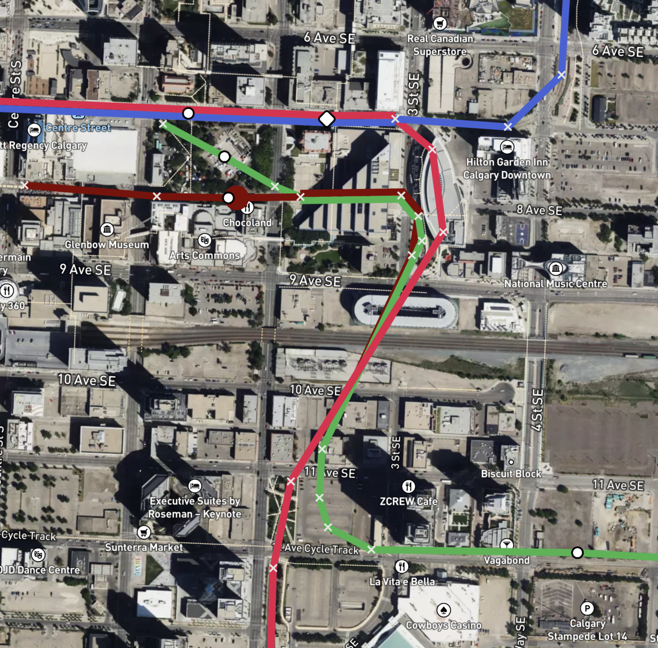

Using 7th or even 8th Ave subway seems impossible without converting to HF trains, right?
Crazy idea:
SE GL moves to 12 Ave, probably gotta be a shallow UG station at arena. Then it connects with the red line underpass and switches into the municipal building tunnel.
But then it forks again to run WNW diagonally across Olympic Plaza for a terminus, leaving the straight 8th Ave ROW for HF trains.

Now it's likely a forever terminus and North is a separate line, but it wouldn't be totally impossible to connect them by running a few blocks up 1st St SE (construction disruption would be unpopular) then turning west on 3 Ave.
With the small empty parcel north of the NE corner of TCC you would have about 250 meters from the Muni Building (maybe even more considering the front plaza/sidewalk in front of west entrance)
Of course you'd have to tear up Olympic Plaza and turn 12 Ave north of Stampede into a construction zone........
What am I missing here...this seems kinda brilliant?

Well I think one piece is that we just had utility companies spend about 2 full years moving utilities from 11 ave to 12 ave for the previous green line alignment. Lol.

Have you taken town planning considerations on boars, headways, ridership, design philosophy amd geotechnical on board, etc, hmmmm.

The issue to investigate would be passenger transfer demand westbound since the terminus is likely too far east. Better than 3rd St SE of course. But would need a detailed analysis on how much better.
Yup it's a bit of a drawback, but it's really the exact same distance (1 full block) to WB 1st St station, which is the same station you'd walk to from GL on 2nd St. In fact it would be even faster from a shallow Olympic Plaza station than a deep 2nd St.
EB puts your transfer the same distance but 1 station further east. But that also means a slightly faster overall travel time.
Of course once red line moves to 8th you are locked into that first/last DT station, but it would hopefully be easier to kill the problem with frequency (what a great problem to have!)
A big plus I see is that stations for all 3 lines would be within a ~100m radius with 0-1 levels of grade separation, vs. ~180m and 1-2 levels in both the near and long term. Does that constant mobility benefit outweigh the overload drawback at absolute peak times?
The green line exists as conceived (an independent access to the centre of the business district) because in the 90s the conclusion was no.
