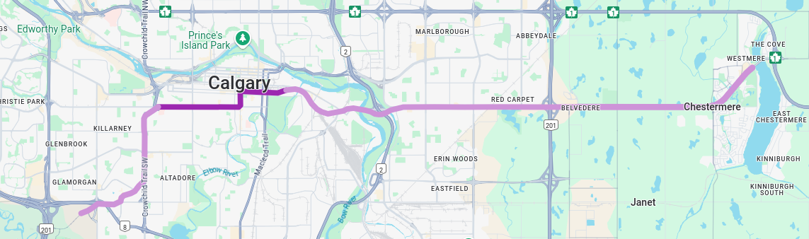

Alright, hate to derail all the bot love but here's a couple of rough pics of what I had in mind.
East portion is the purple brt upgraded to lrt with possible extension further east. It would interline with GL for Inglewood and 4st se stations.

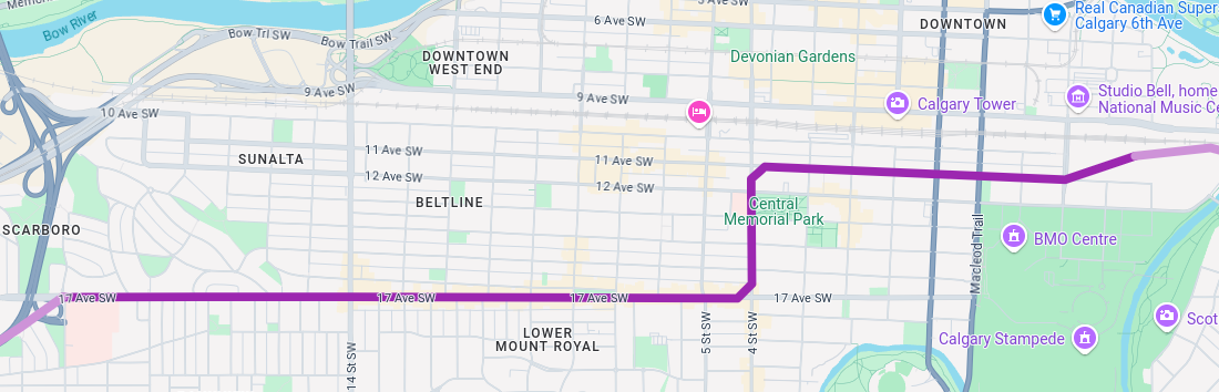

This would be the tunneled portion in city center, using the util cleared 11av row then going south on 4st sw to 17av and exiting at crowchild. A little under 5km long and being further from the river, so should be doable as c&c.

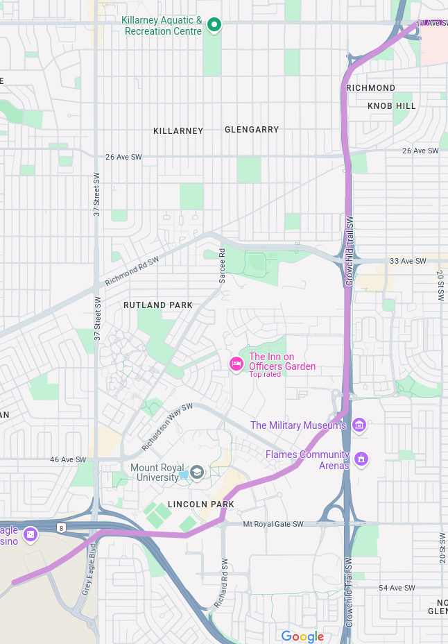

Once its out in crowchild, the line goes elevated down the median, then veers off into MRU territory and on to grey eagle.

Missing a destination (downtown) and transfer by a few blocks would be a waste IMO
The biggest disadvantage of that alignment is that it doesn't have a direct transfer station with either the red or blue lines. Though you could always walk a few blocks from the beltline.
Based on plans from the city, if a line like this is ever built, it would probably leave Crowchild and take Quesnay Woods Dr to go through the core of Currie.
I think it would also be neat if the line could go up 14 St and use 33 Ave to get to the core of Marda Loop. Not sure if that's politically or financially viable though.
Agree on the lack of direct red/blue transfers, not sure how to resolve that, but it's something I'll continue to ponder.
I chose Crowchild for an elevated row to balance access to the neighborhoods, a stop near 33av still provides access to marda loop, but also the areas west. I'm not sure using 14st with Mount Royal on one side is as beneficial, or feasible.
Within Currie, I think the road you're referring to was part of the Westbrook streetcar stub that was pitched at some time?
In short, I'm not a fan of streetcars when they cost skytrain money, and in the Westbrook/MRU case similar service could probably be achieved just as effectively with electric buses for a fraction of the cost.
I don't totally disagree, but from a design philosophy standpoint the idea with this route was to service more areas that aren't already covered, and centrally that meant providing access to more of the beltline.
On the east end, users heading to DT proper can transfer to GL at Inglewood or 4st, as the SE leg isn't expected to be as heavily used.
That option might not be as attractive for users on the sw leg, but extending +15 (or -15?) into the beltline to where a station might be at 11av and somewhere between centre and 4st could help mitigate that.
