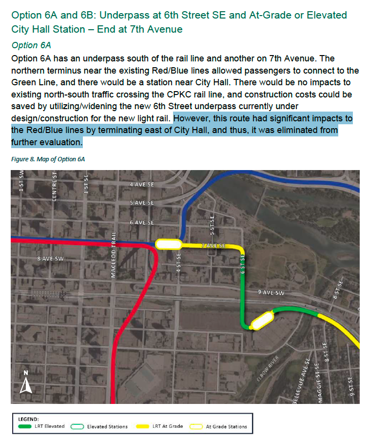

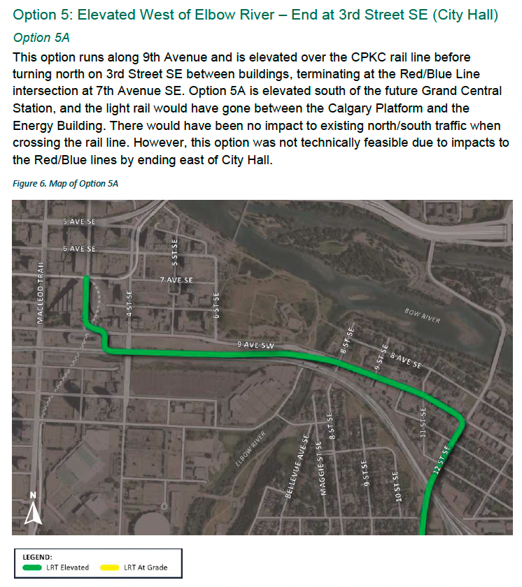

I'd be interested to see, if the city says no to the alignment and clearly communicates the why such as the low design % and major impacts that weren't addressed (pg48 of the report), how quickly the Province does an about face and claims they were only trying to do what's best and the city is a bully etc etc but will fund. It would be on par for their style of knee jerk 'governance'.
And speaking of pg 48, how can you 'design' a transit alignment without any analysis or study of its impact on traffic, transit, property access/egress and noise/ vibration impacts?
This literally was an exercise in can you draw me a line down a street. It's an insult not only to the city and anyone who worked on the GL but every single taxpayer across the Province.

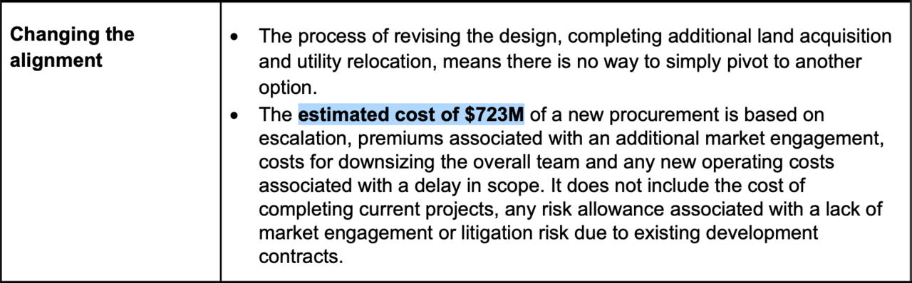

First and foremost - this argument is troublesome. I don't think anyone can say, with a straight face, that the tunnel will cost less than elevated. I see politicians (Nenshi for one) starting to say this, and it makes them look silly. Elevated will be less than a tunnel - there is no doubt about that. Any risks (like below ground issues) for elevated will be a larger risk for a tunnel. The sunk costs are just that sunk - they are gone. The utilities did not need to be done, but upgrading utilities now keeps it from having to be done in the future - so it's not a forever sunk cost.
The problems are less technical for elevated specifically on this project now and I'm not even sure how you quantify it, but certainly nothing we'd figure out on a web forum. What if CP doesn't play ball? What if landowners sue and win? Does a new RFP need to be issued and all the politics of introducing things to the media before discussing with project partners drives up bid costs due to industry pushing back against a flip flopping project team?

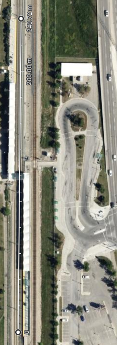

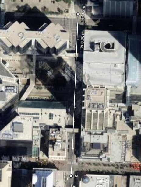

Side note, I think the elevated stations could be much less wide, especially the 7th Avenue Station. Give them the Shawnessy station treatment:
240 Metres long, with a central crossover over 7th Avenue on the mezzanine level, with entrances to central mezzanine and at either end of the station on 8th and 6th Avenues.
-Keeps the track from splitting, saving width
-Central mezzanine over 7th allows for easy transfer to Blue and Red lines.
-Staggering the platforms allows the platform to reach further north and south
Shawnessy on the left, 2nd Street on the right.
