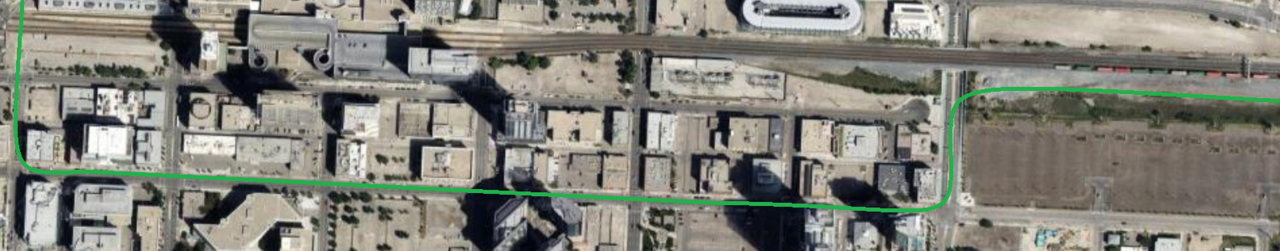

  • Utility conflicts (it was mentioned in the video just moved utilities off 11th to 10th, would need to relocate them back to 11th. Honestly that does suck and would be a sunk cost... Could go down 11th? That means tight turns and slower transit times)
If that’s the case why can’t they do elevated down 11th ?
Elevated down 11 would save utilities from needing to be relocated but there are a lot of other trade offs:
If you're foregoing the Grand Central and having a station at the surface or elevated on 11th and 4th, not sure how the Province would feel about that.
If you're keeping 4th in Grand Central you would need to do some tight turns to get to 11th.
You'd need a tight turn to get north as there is no open parking lot to turn through.
Granted you're going slow for those turns anyways because you're either just leaving or approaching a station

Could the turn from GCS to 11th be done through the big open plot of land to the east (or is that going to be part of GCS)?
No surface running please
That is Remmington's, I don't think they'd like an elevated line going through their developable land.
I also chose this route because it could be elevated. I'll leave my surface up 11th idea behind (sadly)
What are the advantages of 11th? That the street is wider, and it already has utilities removed? And I guess a Beltline station that is 1 block deeper into the community?
If we're going with elevated it just seems like both a longer and more disruptive route, with more storefronts and windows, and fewer parking lots and elevated parkades.
