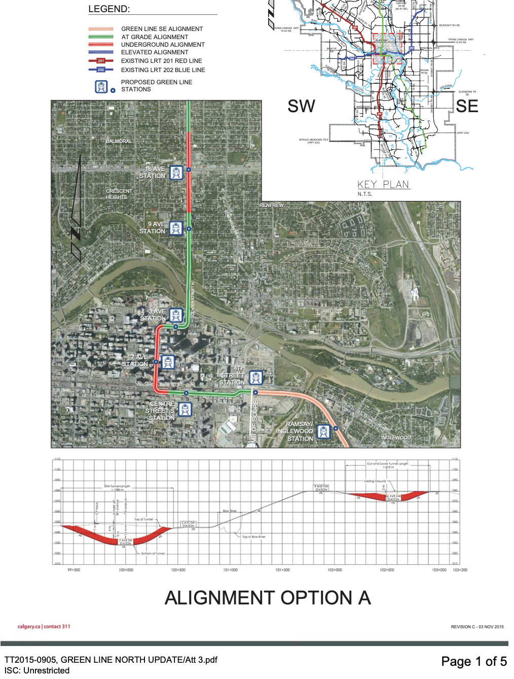

Back in 2015 they did have simpler ideas for a much shorter bored tunnel by taking advantage of tram's tighter turning abilities:
Of course this means running at-grade through Macleods Trail (which I think would have been fine on 11th since they are both one-way roads). This plan still has to deal with the trickiest geology, but I wonder how much savings it would have offered? It also would have cut out all the Eau Claire stuff, including the condo expropriation.
