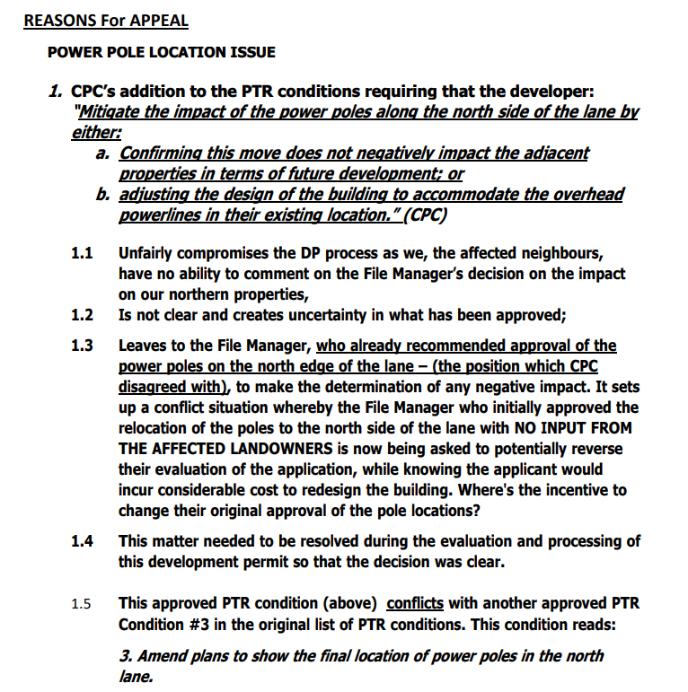

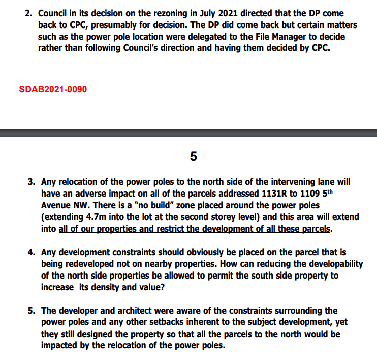

Before we all start hurling calls of NIMBY!, when you read the reasons for appeal, it is pretty interesting, and in my opinion, quite legit. If I lived/owned of the parcels on 5th Ave, I would probably be doing the same. From the package, as can be found on page 4/563 (there HAS to be a better way to assemble SDAB packages.....) the rationale is as follows:
For reference, the power poles are currently on the south side of the lane, adjacent to this project/property:
