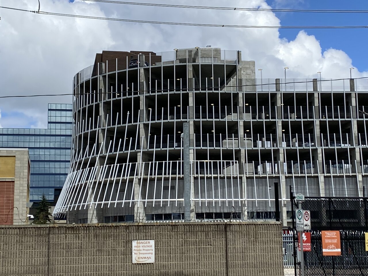

Here is a thought, could that parkade on 10th be capable of supporting a couple short residential towers (say another 5 to 10 stories)? If they converted the ground floor to hold some retail bays, left the next 4 floors or however many there are as parking for residents, and then built a couple small rental condos on top, it could potentially be a big game changer. Not sure the feasibility on it, but if it is possible, that is a good way to start transforming downtown from a parking wasteland into more density. It would save time and money because they would not need to excavate or build any below or above ground parking, it would be ready to go. They would probably need to punch in a couple elevator shafts and then go up from there.
IF they wanted to convert to residential, it wouldn't be too hard to shore up[ the structure. The long rumored change for that building was ground floor retail, would love to see that happen.

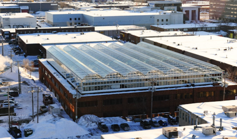

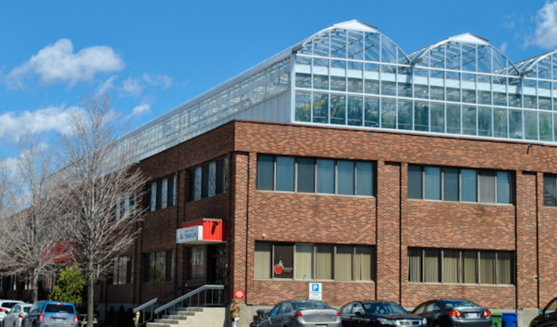

Assuming there is no interest just to tear down our parkades, it would be great if they made the top floor into an actual park too - like with plants. This is not a critique of the pop-up project as that was always intended to be super quick and cheap, but would be cool in a full project to actually take a whole top floor of asphalt out of the heat island and go all out with trees, grass and wind breaks and some solar protection. Either as a park or a greenhouse.
I don't know much about structural loads and requirements so I am imagining some retrofits required - but they were able to make a go with rooftop greenhouses on old warehouses in Montreal, surely the parkade could support something similar.

2. Build glass greenhouse over top of parkade.
Typically structures are only designed for the loads they will see, extra capacity isn't built in (unless for example they plan for it, like Arris). If they changed the use of the parkade floors to something else, there would be some extra capacity from the reduction from cars to people, but not enough for a whole building on top.
You'd probably have to excavate underneath and strengthen everything, like a top-down foundation approach but on an existing building. It's possible, but probably not worth just starting from scratch given that GC's don't really do that in Canada.
