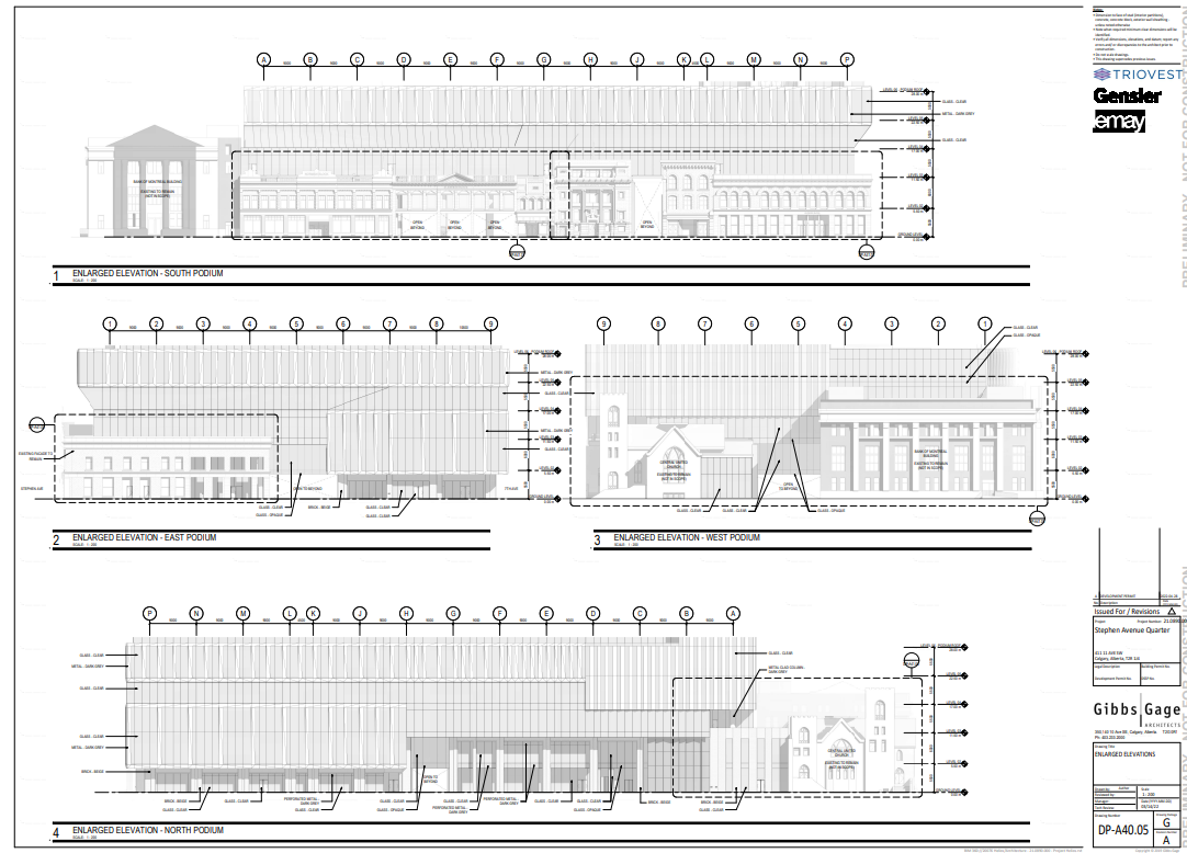

The DP drawings for this project have now been posted:
Office tower (24 stories), rental tower (54 stories) and condo tower (66 stories)
No major renderings in the DP package, but here are some elevations:
View attachment 399101View attachment 399102
It looks like the heritage buildings on 7th ave are being removed......
I will go through these in more detail to see what other info I can glean. Looks to be a pretty massive podium. Hopefully we see some detailed renderings soon.

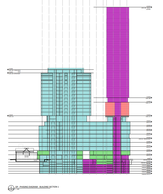

Something is weird with those floor datum elevations on the phasing diagrams.
The Ground Floor lists ‘100000’ with a “?” above it. On the levels above that an extra digit is added.
Is there anything else that confirms the 287m height ? (Michael S - can you help ?).
^ Ignore that question mark on the datum, it might be a revit thing as something does look off with the digits, maybe some parameter was not working properly, the larger sections and elevations seem to show those properly.
Looking at the facade enlarged elevations, I can see that there looks to be some sort of articulation of using some angular formed cladding bands between the glazing, maybe to break up the enormous expanse of the total elevation. I would wager maybe, some kind of formed metal panels with curtainwalls complemented by terra cotta cladding for the solid bits at the podium. I thought I also read T/O LIGHTBOX for the residential towers, I am curious to see what that looks like. I'd also bet that Gensler is the design architect and Lemay the interior design while GGA does the local record keeping and stamping for the construction documents.
Rest assured expect further submissions for revised DP on something like this which will eventually show renders and full elevations etc. The shadowing diagram does show a bit of what the mass of the towers will look like, at 30x30m square floorplates for the residentials I really hope it isn't littered with tacked on balconies or excessively 'slabby' profiles like seen at Guardian and many condos in Toronto.
This DP seemed to be curated to cover the work scope involving the salvage and restoration of the heritage buildings, which will be a fairly careful process so it is good to get that part into the city first while more time is then set aside to get the rest of the new build properly DD'ed and then sent in again with a full gamut of renders, materials which I hope will show genuinely thoughtful efforts in the design with creative solutions for many of the interfaces between old and new..
