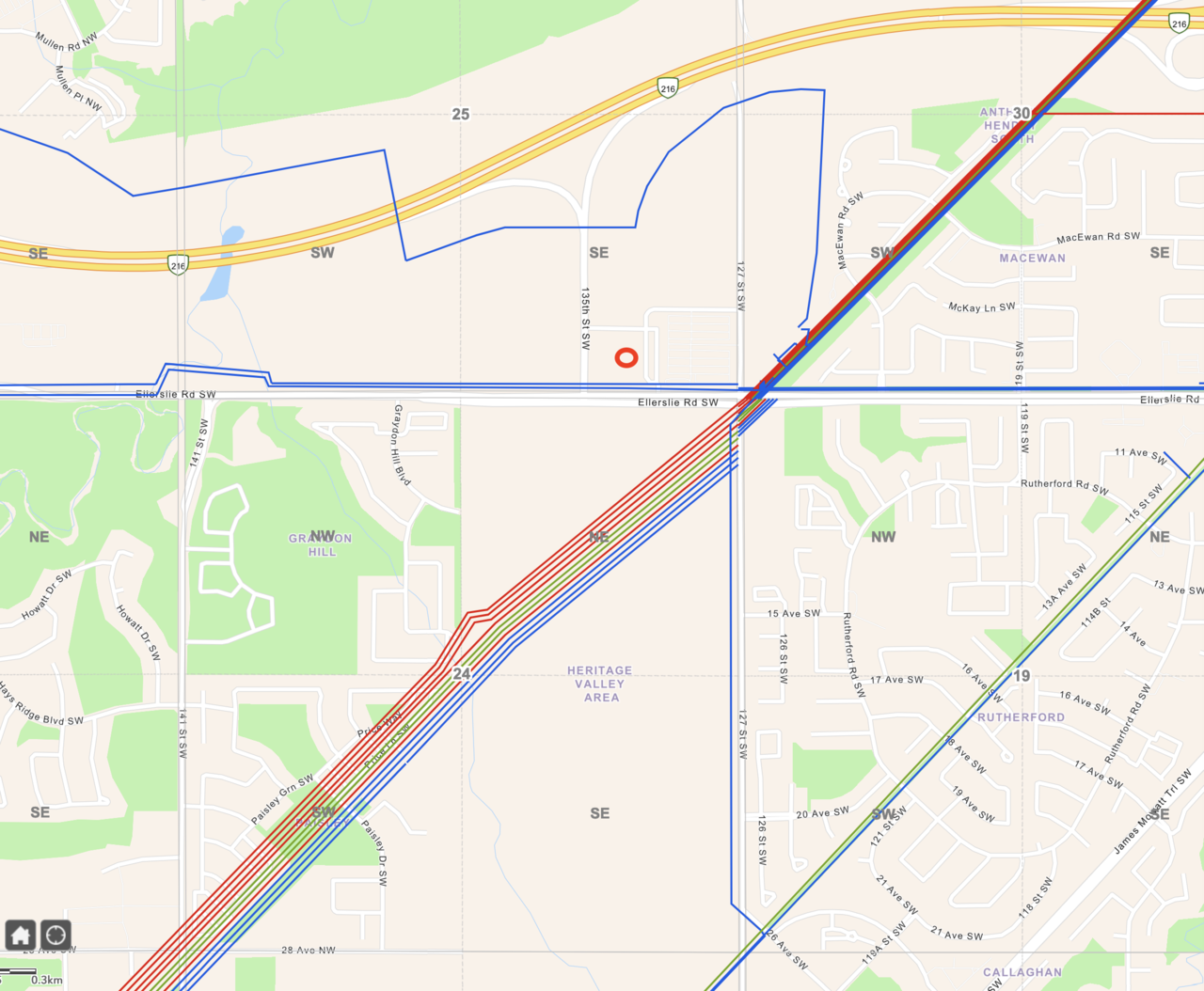

That shouldn’t create problems for trenching Ellerslie Road under the Capital Line Extension though, based on the visible alignment of the pipeline.The reason for not tunneling on Ellerslie is a gas pipeline.
I imagine it's possible, but it would have to be a pretty short trench, and a quick return to grade if this pipeline map is accurate. Red circle is approximately where the City has the station on their extension map (view here). I hope they find a way to do it, because I think it will be a major regret not grade-separating Ellerslie from the beginning.That shouldn’t create problems for trenching Ellerslie Road under the Capital Line Extension though, based on the visible alignment of the pipeline.

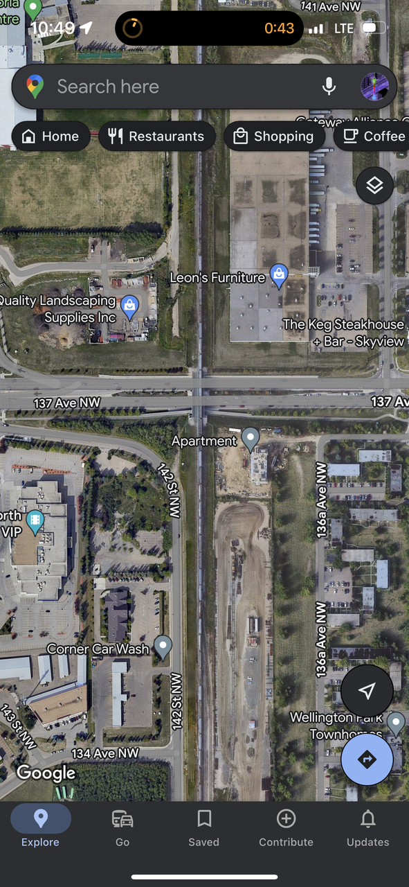

Based on measurements of the 137th Street underpass below the CN rail tracks on the North Side, the roadway needs to descend across ~200 m on each side of the LRT crossing to achieve sufficient clearance with a low-enough grade. Based on the renders, the station will be just west of the transit center, so that should leave enough space between the tracks and the pipeline for the road to dip down. However, there’s not enough space to climb back up and meat Heritage Valley trail at a small-enough grade, so the whole intersection needs to be lowered about halfway.I imagine it's possible, but it would have to be a pretty short trench, and a quick return to grade if this pipeline map is accurate. Red circle is approximately where the City has the station on their extension map (view here). I hope they find a way to do it, because I think it will be a major regret not grade-separating Ellerslie from the beginning.
