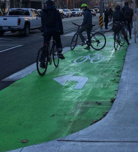

Also, in the 15-minute span I was there, we saw two people wipe out on the green paint. City staff were there and assured us that the green paint is, in fact, no more slippery than regular asphalt, but needless to say folks were skeptical.
You can clearly see how slippery it is from this pic:
That City staff are so oblivious to the obvious comes as no great surprise. Note the concrete plinth to the left of the green paint. That's there to mount a barrier. Why the need for a barrier? Take a close look at how those cyclists are positioned for their turn. Observers may not have seen what can happen yet, but it will happen, for the same reason you queue *any* vehicles save for when lined up for races at an intersection, which needless to say, should be prevented. The turning and then crossing process will not proceed rationally from that point as presently set-up. The northerly flow channel is fine in that regard, the southerly flow one (green) is just bizarre.
Most of you will disagree. I'm on record as stating "I told you so". Other cities don't do it this way for good reason. The Danes and Dutch especially would be aghast at this.
If a pipe railing barrier was installed on the plinth, the green paint would be unnecessary and the whole project much safer, but I digress. A partial barrier to prevent "through-running" of the two streams of cycle direction is also necessary. (Where the two opposing flows meet) It's a matter of time (And I watched this happen even before the official opening) where cyclists would be drawn southbound on Bathurst to enter the green bay and continue the wrong way down the northbound channel.
I visited the 'green bay' yesterday on foot, with thin sole shoes on (akin to real running shoes, not the consumer ones) to check out the adhesive/traction properties of the green section.
It's odd, like no other patch in TO (or elsewhere, save for painting disasters) that I've come across. Perhaps it's an attempt to correct the obvious slippery strips in it (still present), but my impression is that the paint used had no traction grit in it, it was added onto wet paint, and then painted over again, such that a *very* uneven application of grit is now present. Right next to the curb, it is very prominent, something to be avoided as it causes other problems according to guidelines. And then in strips, as mentioned, there is none. That's going to be a nasty situation. One of the problems that presents is someone slipping on the non-gritted streaks, and then falling on the heavily gritted part. It will tear cloth and the skin under it. It will also harbour water, and freeze.
