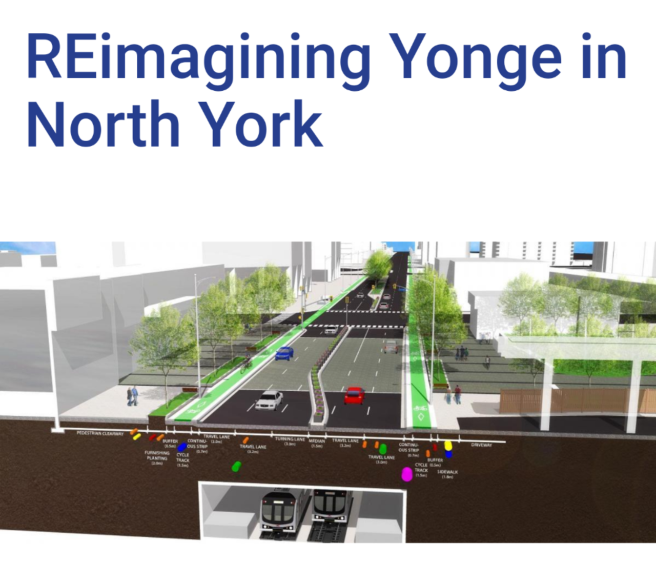

Lateral is so much more important imo, just look at this proposal for "REimagine Yonge"
I would not bike there being so close to 60km an hour cars speeding by
Especially when they can just put the trees between the cycle track and the street.
