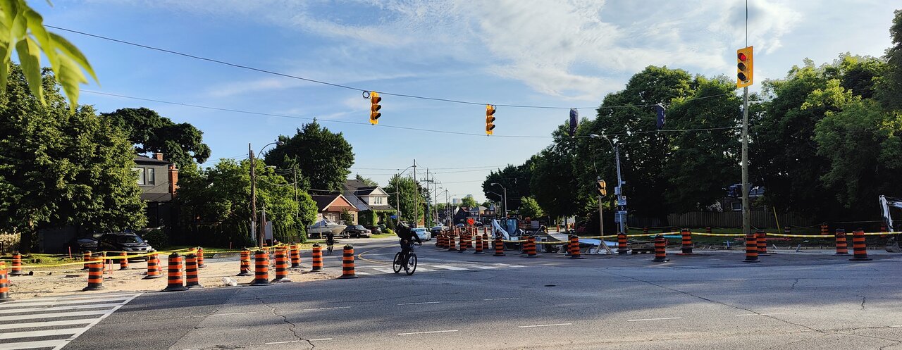

I took some photos today. They've largely removed the islands from Millwood to Pape and between Pape and Donlands. Photos are from the northeast side.
View attachment 569354View attachment 569355
Holy hell, this is a yet another brutal work zone. As of this week, Millwood southbound goes from 3 lanes to 1 lane just before the Donlands/Pape split. Traffic has been backed up to Overlea in the pm rush. It took 15 min to traverse that by bus today. Islands are all gone. I'll try to get photos tomorrow, depending on TTC strike and how long it takes me to bike to/from work!

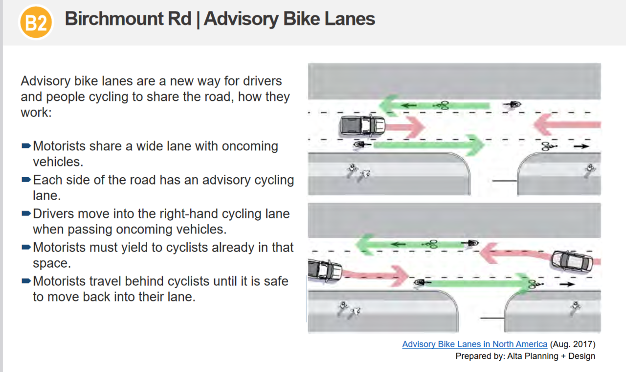

I'm mostly saving my comments for a separate post............ but I'm going to put out there right now that I'm having none of this 'advisory' bike lane business.......
Here's an explainer:
I think this is a recipe for confusion and collision.
Continued from above:
Agreed, I definitely do not like those "Advisory Bike Lanes"....

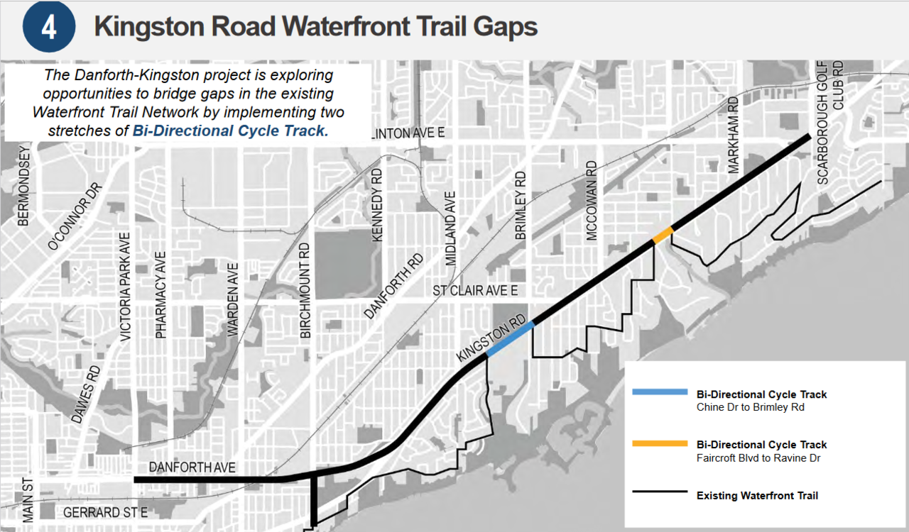

I received this in my mailbox today from the City.
I assume it was distributed to all the communities along the Danforth Kingston route. :)
Gotta love this part:
"This 10-kilometre route is a critical part of Toronto's transportation network. In the near term, road resurfacing is planned on Kingston Road between St. Clair Avenue East and Markham Road. This presents an opportunity that comes only once every 25 years to incorporate changes and take a complete street approach to the street design that accommodates pedestrians, people cycling, using transit, and driving, which can improve safety for all." (my bold)

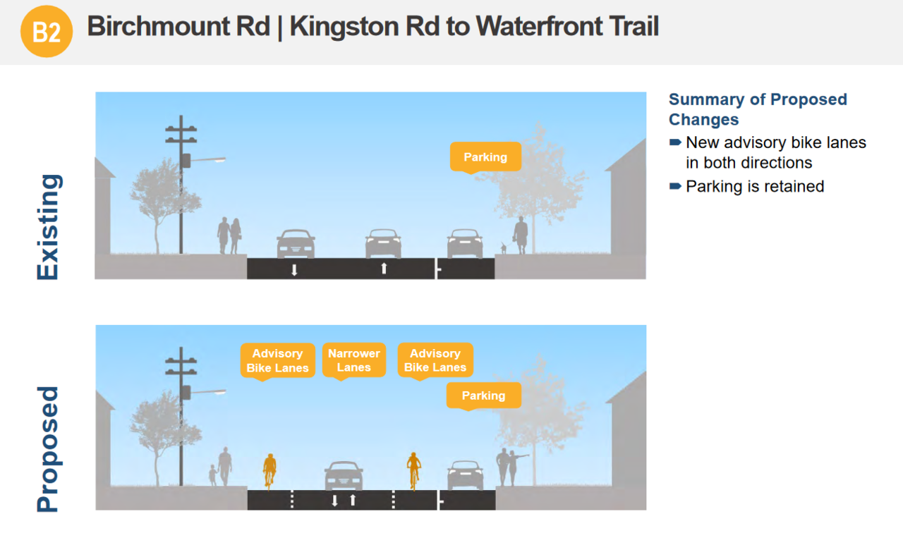

I've ridden a similar style of bike lane in the Netherlands and it worked well, but drivers there tend to be much more deferential to people on bikes and this only really works if a) it's a low-traffic street and b) drivers yield properly.
I also saw a similar design in Victoria when I visited recently. Not sure how they're working out there.
This short street segment sees a surprising amount of traffic, it may be used for purposes of accessing Variety Village (off Danforth), Scarborough Gardens Arena, the Community Centre, the Catholic school, houses fronting the street, flow-through from Birchmount/access to Danforth/access to Kingston Rd; as well as traffic coming off Hollis (the extension of Gerrard/Clonmore)
You've got a lot of of pick-up/drop-off activity, lots of turning movements.
I just think drivers here would find this design confusing/challenging.
I think the confusion will be that based on the citiy’s studies, speeds on birchmount exceed the speed limit(they’re more akin to an arterial as opposed to a local street). So it’s unlikely this treatment will work as expected unless there are additional methods of calming traffic.
