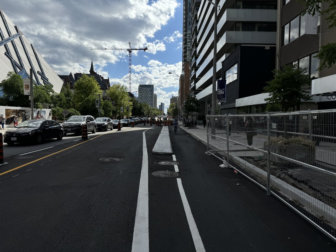

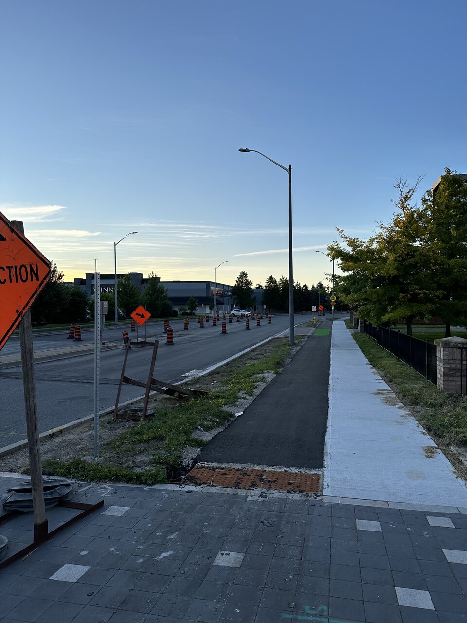

Toronto often has low public realm design standards that are almost laughable. Here, a utilitarian mini-highway barrier is seen as the aesthetically pleasing "final" design option.
I've seen permanent concrete planters with shrubs and perennials in other cities as the separator for separated bike lanes. I've seen a strip of trees as the separator. Here's a somewhat basic design from Vancouver that's nicer than anything we have (short of perhaps the flagship Martin Goodman Trail along Queens Quay). Here's another example.
The benefits to lush landscaped designs are multi-fold. They make cycling more relaxing and pleasant. They're aesthetically pleasing and calming, which can make even car-driving conservatives happy (especially if they're beautifying their neighbourhood and increasing their property values). As the trees mature, they'll add shade which will make cycling even more comfortable and pleasant as well.
Designs with landscaped buffers have been done for Sheppard, Queensway and Gerrard among others..............you'll see a lot more of that in the years ahead.
We've already introduced a few small bits on Dundas East and Danforth east of Dawes.
These two did not feature trees, due to utility conflicts, but trees will be incorporated in many designs:
North side of Bloor west of Avenue wrapping up.

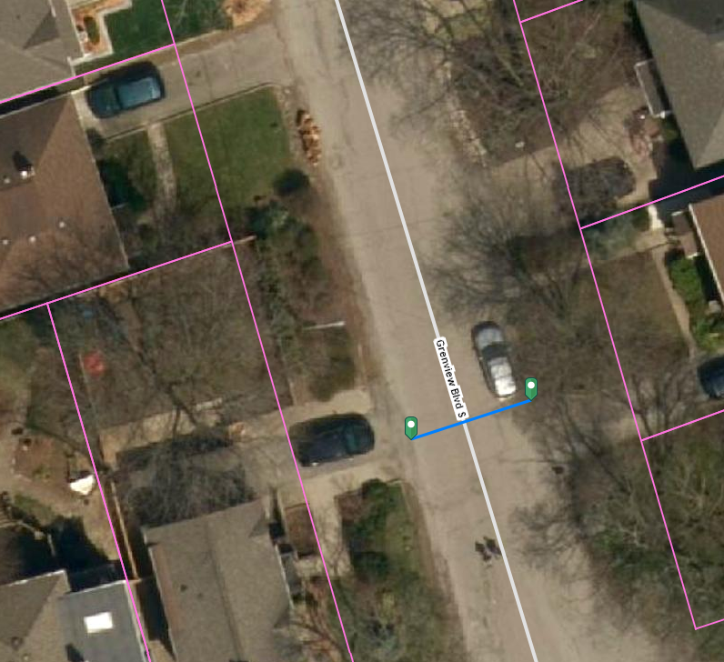

Even a bi-directional multi-use path here would require 3M, plus 0.8M buffer.
From a 7.5M cross section....the math doesn't add up. As the pink lines reveal, there's plenty of ROW there if we take people's front yard's away........but
I think you'd have to take 1.5M off all the front yards here.
Otherwise, this is just a signed bike route, nothing else.
Also I measure it as 400M longer than the straighter equivalent distance on Islington.
