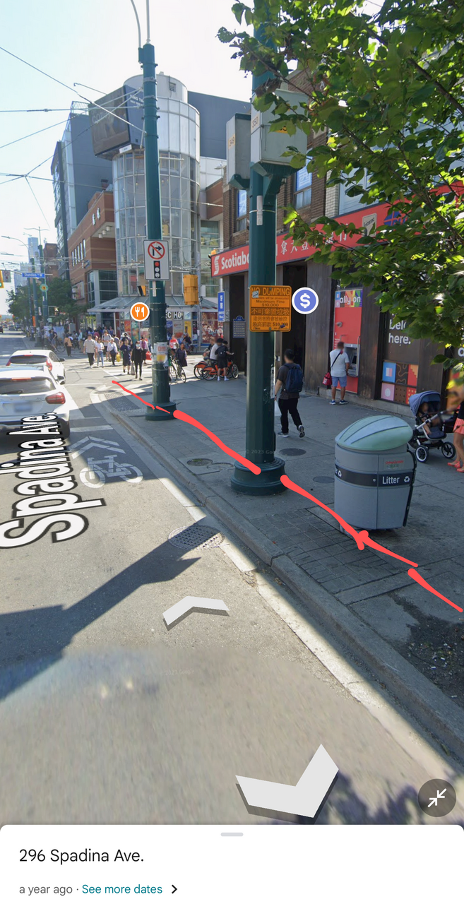

something like this? if the standard for expected pedestrian volume here is 6 meters obviously this wouldn't be acceptable
Nah, it really wouldn't work from a perspective of pedestrian safety, but even if that compromise were made.........you'd have to move the light fixtures.........no small matter...........
Also...it just wouldn't get you enough room. The curb lane there is currently 'shared' at 3.8M. If you firm it up, really tight........you could get 0.8M for a cycle track/bike lane. To get just to 1.8M you'd have to take almost 1/3 of the sidewalk at that corner.
There's just no way to make that work. (without removing a car lane)
The right-hand lane is significantly wider than the left-hand lane already. I don't know how much you could narrow the lanes to the absolute minimum.
At the intersection itself - if you get rid of left-turns for cars - the problem goes away.

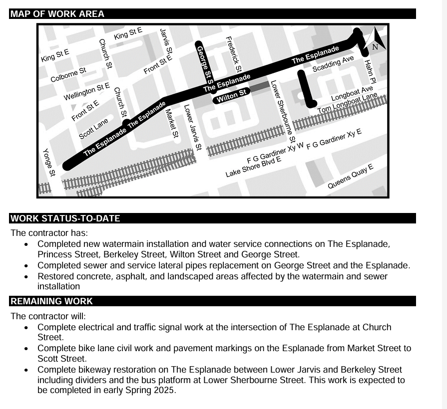

They finally repainted the Esplanade bike lanes East of Jarvis. Still no sign of anything west of Jarvis, and weren’t they supposed to be installing proper dedicated (not just painted) bike lanes East of Jarvis this spring? Why even bother painting them at this point? Unless they delayed it again?
It’s being tied into the David Crombie Park revitalization, with the following advertised timeline, which may well have slipped since being published late last year.
  • Spring 2025: Hire a construction team
  • Summer 2025: Construction for park and cycle track starts
  • December 2025: Construction for cycle track complete
East of Jarvis The Esplanade is very lightly trafficked so I’m sure there haven’t been many cyclist complaints about all the rejigging. It’s still disappointing though.

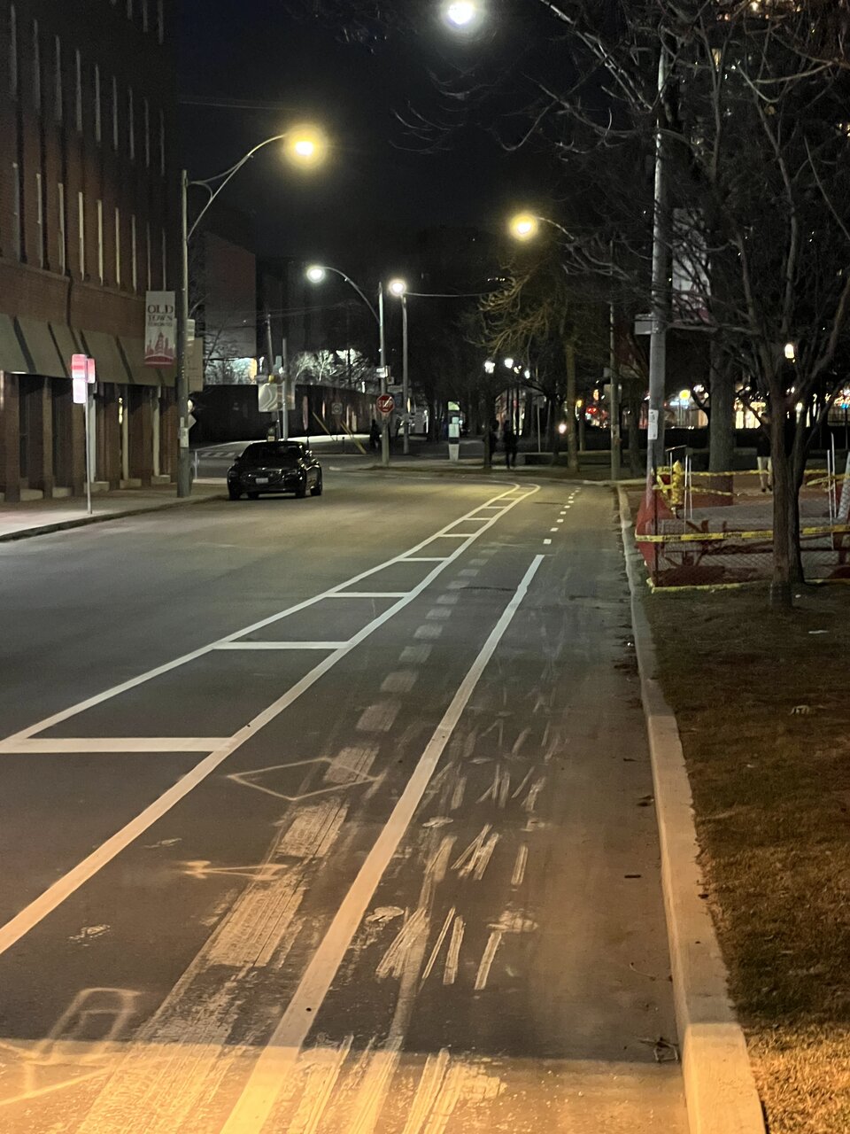

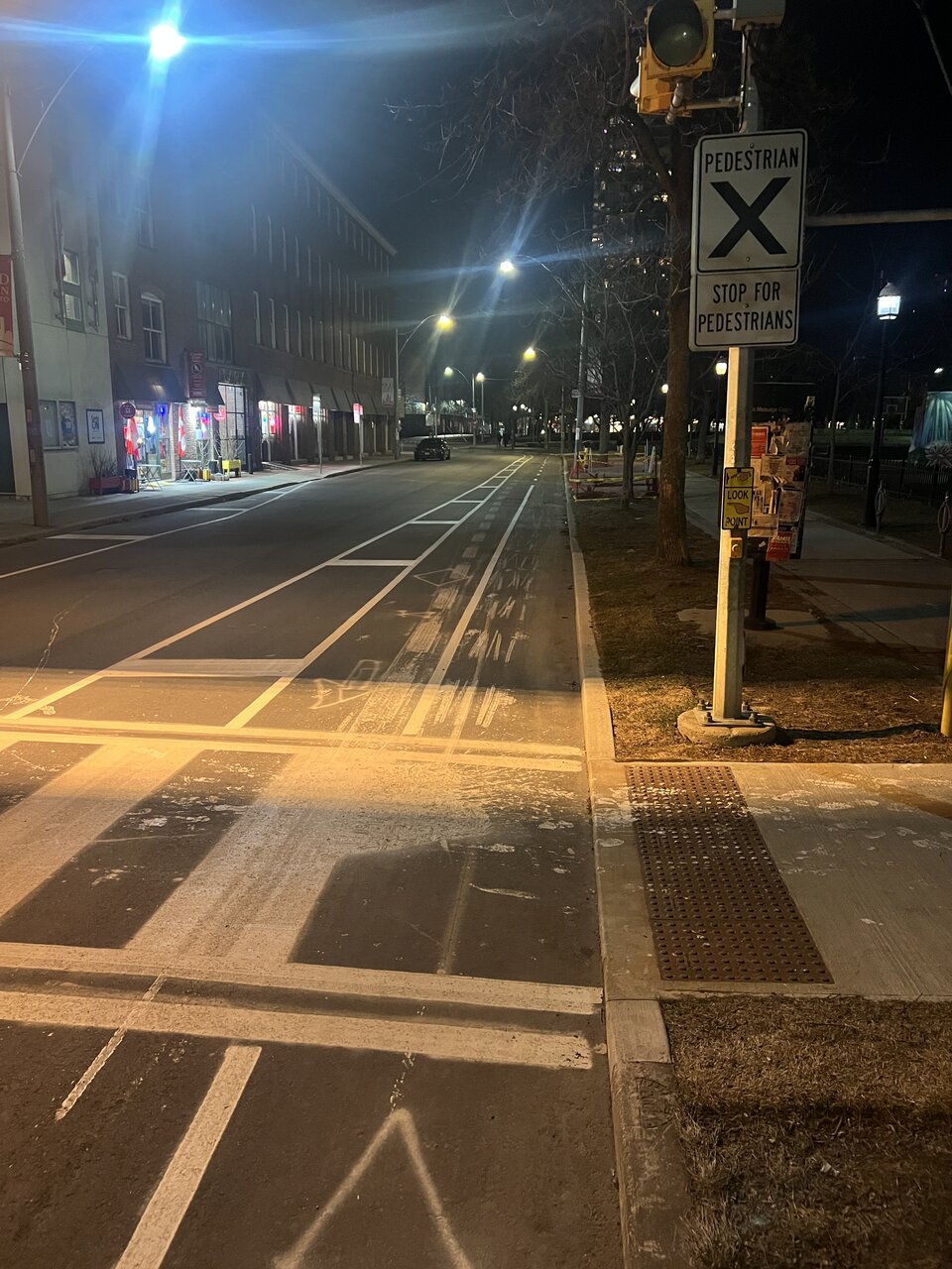

The new (sloppy) bike lane lines on the Esplanade after many months of nothing. People in their cars are still driving the wrong way down the "no entry" portion of the street though.

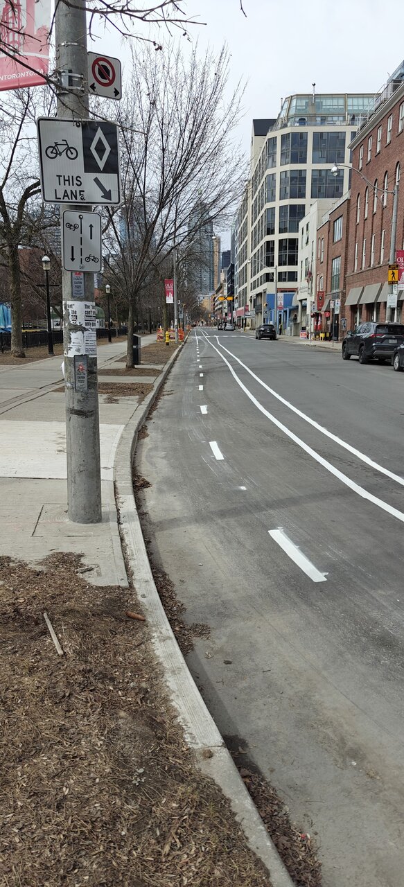

The work is ongoing...
Cycling told me last week that:
In parallel to this is the work we are bundling cycletrack upgrades with the delivery of the David Crombie Park (DCP) Revitalization project, which is wrapping up design and should start construction mid-summer. It will include raising the quick-build two-way cycletrack between George Street and Berkeley Street/Hahn Place to sidewalk height. The DCP construction will also make the connection west to Market Street, as this work had to be deferred from the 2024 plan due to coordination with the temporary St. Lawrence Market tent, which is located between Market Street and Jarvis Street. There is a mailing list for DCP under the “Get Involved” tab on the project website, in case you’d like to subscribe to project updates.
